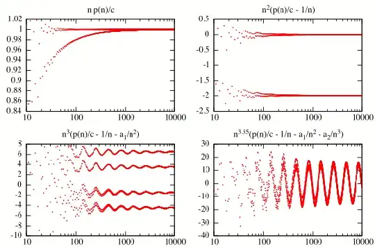

After getting some insight by looking at some numerical calculations to see what $np(n)-c$ looks like for large $n$, I can now describe the convergence in some detail. First, the results of the simulations strongly suggested the following.
  • for $n$ odd, $np(n)$ converges to $c$ from below at rate $O(1/n)$.
  • for $n$ a multiple of 4, $np(n)$ converges to $c$ from above at rate $O(1/n^2)$.
  • for $n$ a multiple of 2, but not 4, $np(n)$ converges to $c$ from below at rate $O(1/n^2)$.
This suggests the following asymptotic form for $p(n)$. $$ p(n)=\frac{c}{n}\left(1+\frac{a_1(n)}{n}+\frac{a_2(n)}{n^2}\right)+o\left(\frac{1}{n^3}\right) $$ where $a_1(n)$ has period 2, with $a_1(0)=0$, $a_1(1) < 0$ and $a_2(n)$ has period 4 with $a_2(0) > 0$ and $a_2(2) < 0$. In fact, we can expand $p(n)$ to arbitrary order [Edit: Actually, not quite true. See below] $$ \begin{array} {}p(n)=c\sum_{r=0}^s\frac{a_r(n)}{n^{r+1}}+O(n^{-s-2})&&(1) \end{array} $$ and the term $a_r(n)$ is periodic in $n$, with period $2^r$. Here, I have normalized $a_0(n)$ to be equal to 1.
We can compute all of the coefficients in (1). As $p$ satisfies the recurrence relation $$ \begin{array} \displaystyle p(n+1)=(1+1/n)p(n)-1_{\lbrace n\textrm{ even}\rbrace}\frac2np(n/2) -1_{\lbrace n=1\rbrace}.&&(2) \end{array} $$ we can simply plug (1) into this, expand out the terms $(n+1)^{-r}=\sum_s\binom{-r}{s}n^{-r-s}$ on the left hand side, and compare coefficients of $1/n$. $$ \begin{array} \displaystyle a_r(k+1)-a_r(k)=a_{r-1}(k)-\sum_{s=0}^{r-1}\binom{-s-1}{r-s}a_{s}(k+1)-1_{\lbrace k\textrm{ even}\rbrace}2^{r+1}a_{r-1}(k/2).&&(3) \end{array} $$ Letting $\bar a_r$ be the average of $a_r(k)$ as $k$ varies, we can average (3) over $k$ to get a recurrence relation for $\bar a_r$. Alternatively, the function $f(n)=\sum_r\bar a_rn^{-r-1}$ must satisfy $f(n+1)=(1+1/n)f(n)-f(n/2)/n$ which is solved by $f(n)=1/(n+1)=\sum_{r\ge0}(-1)^rn^{-r-1}$, so we get $\bar a_r=(-1)^r$. Then, (3) can be applied iteratively to obtain $a_r(k+1)-a_r(k)$ in terms of $a_s(k)$ for $s < r$. Together with $\bar a_r$, this gives $a_r(k)$ and it can be seen that the period of $a_r(k)$ doubles at each step. Doing this gives $a_r\equiv(a_r(0),\ldots,a_r(2^r-1))$ as follows $$ \begin{align} & a_0=(1),\\\\ & a_1=(0,-2),\\\\ & a_2=(7,-3,-9,13)/2 \end{align} $$ These agree with the numerical simulation mentioned above.
Update: I tried another numerical simulation to check these asymptotics, by successively subtracting out the leading order terms. You can see it converges beautifully to the levels $a_0$, $a_1$, $a_2$ but, then...
convergence to asymptotics
... it seems that after the $a_2n^{-3}$ part, there is an oscillating term! I wasn't expecting that, but it there is an asymptotic of the form $cn^{-r}\sin(a\log n+\theta)$, where you can solve to leading order to obtain $r\approx3.54536$, $a\approx10.7539$.

  • I see some other people have also mentioned numerical simulations, and what they found seems to agree perfectly with what I saw and with the analysis in my answer. – George Lowther Sep 16 '10 at 22:03
    @George: beautiful! The plot of n^2( np(n)- 1/n) to n=10000 seems to rule out oscillations in the dominant term of the asymptotics for np(n). (But a detailed proof would still be reassuring...) The oscillation term is equivalent to a complex power of 1/n in the asymptotics, which is certainly suggestive. – T.. Sep 20 '10 at 16:40
  • T.. - yes, complex powers of n are indeed suggestive. I just realized how you can generate the entire asymptotic expansion to all orders. Instead of generating functions, use a Dirichlet series. Then the asymptotic expansion comes from inverting this in the same way as for the explicit formula for the prime counting function! – George Lowther Sep 23 '10 at 00:08

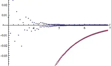

Here is an observation: It looks like $(2n) p(2n) - c$ converges to $0$ much faster than $(2n+1) p(2n+1)-c$ does. Here is a plot of the points $(\log n, n p(n) -c)$, with blue points for$n$ even and red points for $n$ odd.
alt text
It might be easiest to first prove the result for $n$ even, then use the fact that $(2n) p(2n) - (2n-1) p(2n-1) = p(2n) + p(2n-1)$ to get that the odd and even points must have the same limit.
  • Thanks, I will try to pursue your idea. Your graph also suggests to me the opposite strategy. For example, the purple points seems to converge to zero more slowly, but show some monotonic behaviour. In particular, I think that the subsequence (4n+3)p(4n+3) may be increasing. –  Sep 15 '10 at 15:47
  • thanks for the graph. It is not hard to show that, for b(n)=np(n), if it converges, then b(n+1)-b(n) is O(1/n) but b(n+2)-b(n) is O(1/n^2), but further analytic control seems again to hinge on ruling out oscillation. The upper graph looks like there might be some slow undulation (e.g. from 5 to 7) and based on experience with other sequences it might or might not die out in the limit. The analogous continuous problem seems like it should have convergence (as here b(n) would be a genuine average) but issue is then how to account for the effect of b(n) not being an exact average. – T.. Sep 15 '10 at 18:11
