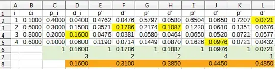

An example with $n=4$ bags and $k=5$
In yellow, the selected bags in each attempt. In orange, the probability of having found the white ball at that point.
