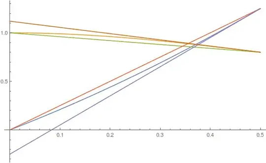

It is not difficult to show that there are just two real solutions, since
  • $x^2+2x$ is decreasing from $+\infty$ to $-1$ on $(-\infty,-1]$, while $\frac{1}{x^2+1}$ is increasing from $0$ to $\frac{1}{2}$;
  • over $[-1,0]$ we have $x^2+2x\leq 0$ but $\frac{1}{x^2+1}>0$;
  • $x^2+2x$ is increasing from $0$ to $+\infty$ on $\mathbb{R}^+$, while $\frac{1}{x^2+1}$ is decreasing from $1$ to $0$.
Let's say we are interested in finding the positive root, which lies in $I=\left[0,\frac{1}{2}\right]$.
Over such interval $a(x)=x^2+2x$ is increasing and convex, $b(x)=\frac{1}{x^2+1}$ is decreasing and concave.
This suggests a tweak of the Newton-Raphson iteration:
We are interested in the intersection between the blue and orange curves, which lies on the left of the intersection between the sienna and the purple tangent lines. By solving $$ 3x-\frac{1}{4} = \frac{28}{25}-\frac{16}{25}x $$ we find that $\frac{137}{364}$ is already a good approximation of the solution in $[0,1]$. Newton's method (applied to $a(x)-b(x)$) with such starting point is granted to converge quadratically (and in a monotonic way) to the actual solution $0.3708102352\ldots$
