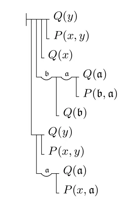

A (negative) anecdote comes from mathematical logic, where we really dodged a bullet fired by Frege. The way we typically write formulas nowadays (using symbols like $\forall$, and $\exists$, $\land$, $\lor$, $\lnot$, $\to$, etc.) was not the first notation tried. Indeed Frege invented a notation for logical formulas called Begriffsschrift, which would have completely killed logic if it had been adopted widely. It is 2 dimensional, and here's an example of it in use:
$[\forall a. (P(x,a) \to Q(a)) \to P(x,y) \to Q(y)] \to [\forall b . Q(b) \to \forall a . P(b,a) \to Q(a)] \to Q(x) \to P(x,y) \to Q(y)$
(I grant you, this is a complicated formula, but I bet you can read it fairly quickly. Look what it becomes):
Frege
While you could make an argument saying we read the first one faster because it's what we're used to, it is objectively more compact. Imagine writing formulas at a blackboard, or deriving things with proof trees using Frege's notation. I shudder at the thought.
