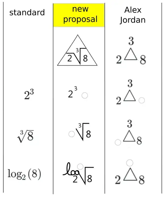

Always assuming $x>0$ and $z>0$, how about: $$\begin{align} x^y &={} \stackrel{y}{_x\triangle_{\phantom{z}}}&&\text{$x$ to the $y$}\\ \sqrt[y]{z} &={} \stackrel{y}{_\phantom{x}\triangle_{z}}&&\text{$y$th root of $z$}\\ \log_x(z)&={} \stackrel{}{_x\triangle_{z}}&&\text{log base $x$ of $z$}\\ \end{align}$$ The equation $x^y=z$ is sort of like the complete triangle $\stackrel{y}{_x\triangle_{z}}$. If one vertex of the triangle is left blank, the net value of the expression is the value needed to fill in that blank. This has the niceness of displaying the trinary relationship between the three values. Also, the left-to-right flow agrees with the English way of verbalizing these expressions. It does seem to make inverse identities awkward:
$\log_x(x^y)=y$ becomes $\stackrel{}{_x\triangle_{\stackrel{y}{_x\triangle_{\phantom{z}}}}}=y$. (Or you could just say $\stackrel{}{_x\stackrel{y}{\triangle}_{\stackrel{y}{_x\triangle_{\phantom{z}}}}}$.)
$x^{\log_x(z)}=z$ becomes $\stackrel{\stackrel{}{_x\triangle_{z}}}{_x\triangle_{\phantom{z}}}=z$. (Or you could just say $\stackrel{\stackrel{}{_x\triangle_{z}}}{_x\triangle_{z}}$.)
$\sqrt[y]{x^y}=x$ becomes $\stackrel{y}{\triangle}_{\stackrel{y}{_x\triangle_{\phantom{z}}}}=x$. (Or you could just say $\stackrel{}{_x\stackrel{y}{\triangle}_{\stackrel{y}{_x\triangle_{\phantom{z}}}}}$ again.)
$(\sqrt[y]{z})^y=z$ becomes $_{\stackrel{y}{_\phantom{x}\triangle_{z}}}\hspace{-.25pc}\stackrel{y}{\triangle}=z$. (Or you could just say $_{\stackrel{y}{_\phantom{x}\triangle_{z}}}\hspace{-.25pc}\stackrel{y}{\triangle}_z$.)
Having $3$ variables, I was sure that there must be $3!$ identities, but at first I could only come up with these four. Then I noticed the similarities in structure that these four have: in each case, the larger $\triangle$ uses one vertex (say vertex A) for a simple variable. A second vertex (say vertex B) has a smaller $\triangle$ with the same simple variable in its vertex A. The smaller $\triangle$ leaves vertex B empty and makes use of vertex C.
With this construct, two configurations remain that provide two more identities:
$_{\stackrel{y}{_\phantom{x}\triangle_{z}}}\hspace{-.25pc}\stackrel{}{\triangle_z}=y$ states that $\log_{\sqrt[y]{z}}(z)=y$.
$\stackrel{\stackrel{}{_x\triangle_{z}}}{_\phantom{x}\triangle_{z}}=x$ states that $\sqrt[\log_x(z)]{z}=x$.
I was questioning the usefulness of this notation until it actually helped me write those last two identities. Here are some other identities:
$$\begin{align} \stackrel{a}{_x\triangle_{\phantom{z}}}\cdot\stackrel{b}{_x\triangle_{\phantom{z}}}&={}\stackrel{a+b}{_x\triangle_{\phantom{z}}}& \frac{\stackrel{a}{_x\triangle_{\phantom{z}}}}{\stackrel{b}{_x\triangle_{\phantom{z}}}}&={}\stackrel{a-b}{_x\triangle_{\phantom{z}}}& _{\stackrel{a}{_x\triangle_{\phantom{z}}}}\hspace{-.25pc}\stackrel{b}{\triangle} &={}\stackrel{ab}{_x\triangle_{\phantom{z}}}\\ \stackrel{}{_x\triangle_{ab}}&={}\stackrel{}{_x\triangle_{a}}+\stackrel{}{_x\triangle_{b}}& \stackrel{}{_x\triangle_{a/b}}&={}\stackrel{}{_x\triangle_{a}}-\stackrel{}{_x\triangle_{b}}&\stackrel{}{_x\triangle}_{\stackrel{b}{_a\triangle_{\phantom{z}}}}&=b\cdot\stackrel{}{_x\triangle}_{a} \\ \stackrel{-a}{_x\triangle_{\phantom{z}}}&=\frac{1}{\stackrel{a}{_x\triangle_{\phantom{z}}}}& \stackrel{1/y}{_x\triangle_{\phantom{z}}}&=\stackrel{y}{_\phantom{x}\triangle_{x}}& \stackrel{}{_x\triangle_{1/a}}&=-\mathord{\stackrel{}{_x\triangle_{a}}}\\ \stackrel{}{_a\triangle_{b}}\cdot\stackrel{}{_b\triangle_{c}}&=\stackrel{}{_a\triangle_{c}}& \stackrel{}{_a\triangle_{c}}&=\frac{\stackrel{}{_b\triangle_{c}}}{\stackrel{}{_b\triangle_{a}}}& \stackrel{\stackrel{-n}{_y\triangle_{\phantom{z}}}}{_x\triangle_{\phantom{z}}}&=\stackrel{\stackrel{n}{_y\triangle_{\phantom{z}}}}{_\phantom{x}\triangle_{x}}& \end{align}$$

    You can go simpler. Consider " $b \stackrel{p}{\lrcorner} r$ ", with "$b$" the base, "$p$" the power, and "$r$" the result (for lack of a better word), with a fill-in-the-blank philosophy. Note that the symbol points to the components that "create" the result, making a visual connection (and breaking the 3-way symmetry). Interestingly, " $b \stackrel{p}{\lrcorner}$ " resembles " $b^p$ " (we can say the "$\lrcorner$" is "understood"); and " $\stackrel{p}{\lrcorner} r$ " is reminiscent of "$\sqrt[p]{r}$"; also, " $b \lrcorner r$ " has a (backwards, or tipped-over) "L", for "logarithm". :) – Blue Jul 03 '12 at 22:40
    (con't) I think I'd allow the "$\lrcorner$" symbol to be reversed, as well. We can write either " $\stackrel{p}{\lrcorner} r$ " or "$r \stackrel{p}{\llcorner}$ " for the $p$-th root of $r$; likewise, " $b \lrcorner r$ " or " $r \llcorner b$ " for the base-$b$ logarithm of $r$; even " $\stackrel{p}{\llcorner}b$ " for $b$ to the $p$-th power, if someone really wanted that. The point is that the symbol --in any orientation-- makes clear what the roles of the components are: the horizontal arm points to base, vertical to power, and result stands against the wall. – Blue Jul 03 '12 at 22:51
    @Blue You're explanation is biased towards exponentiation over roots or logs. The language you use refers to the "result" and how "the symbol points to to the components that create $r$". Maybe they do, but no more than say $p$ and $r$ "create" $b$. I think I was aiming here for a symmetry with respect to any bias towards one of the operations. I can get behind the symbol itself, but not the explanation. Then again, I don't really see what advantage $\lrcorner$ has since left is still left and right is still right. – 2'5 9'2 May 13 '13 at 20:37
    @alex.jordan: If it weren't well past the five-minute comment-editing deadline, I might be inclined to remove the "create" aspect of my description. :) The last line of my "(con't)" comment addresses this advantage: it's not just (or even) left-right positioning, but horizontal-vertical armature, that indicates the role of each component. Also, notational symmetry is problematic without operational symmetry. Your triangle notation burdens the brain with having to remember which (very different) identity rules apply to which (visually identical) corners. Unlike things should look unlike. – Blue May 13 '13 at 22:40
  • @alex.jordan: I'm not entirely down on your notation. Granted, the identities corresponding to power rules and log laws are a bit daunting, but I do like your observation about the similarity of structure in the inverse identities. It's as if matching numbers in matching corners "cancel" and leave the other number; there's something satisfying about that. :) – Blue May 13 '13 at 23:00
  • @Blue Someone up-voted this answer today and it made me look at everything again. Bleary-eyed, I thought your comment was the news. I should pay more attention to dates before adding to comment threads :) Your points are taken and well-made. – 2'5 9'2 May 13 '13 at 23:57
  • @alex.jordan This is really cool. It will be helpful for thinking about much more than just exponents and the related concepts – Hal Mar 29 '14 at 13:03

    Your idea got made into a YouTube video called the Triangle of Power – Mark May 04 '16 at 12:41
  • 39
    Excellent video names this notation Triangle of Power by the illustrious 3Blue1Brown. – Bob Stein May 04 '16 at 12:43

That’s my proposal for a "unified notation". Differs from Alex.Jordan's in two respects:
  1. "It needs to be a symbol with 3 'input' areas, that isn't symmetric under any rotation or reflection". Rationalist
  2. It’s closer to standard notation.
I love Day Late Don's vee-wedge notation. It's easy to remember $\wedge$ stands for exponentiation, while inverting it is the inverse operation. I'd like to go even further with that, and just use it as an operator symbol. If $a \times b$ is just $a$ added to itself $b$ times, and $a^{b}$ is just $a$ multiplied by itself $b$ times, why does exponentiation even deserve the fancy superscript notation? In fact, we can extrapolate (wrong term?) an infinite set of operators, creating each simply by saying it is equal to the last one applied to the same number ($a$) $b$ times, e.g. $a \times a$ repeated $b$ times is $a \wedge b$, $a \wedge a$ repeated $b$ times is $a$ 㫟 $b$, or whatever notation you want to use there, etc. Sorry if this doesn't answer anything for you.
