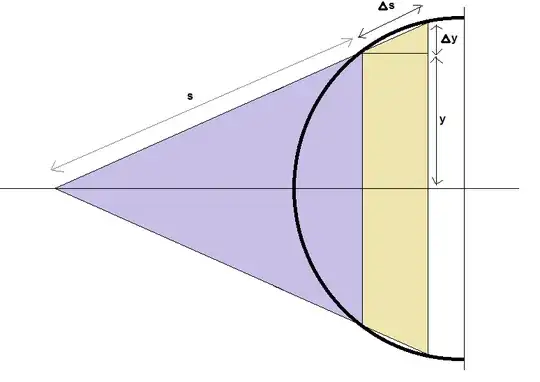

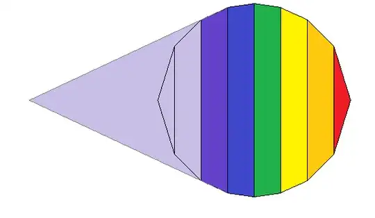

Note that we can approximate the surface area by fitting a series cones over the sphere. These cone segments are called frustums, and are used to find the area of almost any surface of revolution.
figure 3
Normally, we represent the area of a cone as $\pi r s$, where $r$ is the radius of the base and $s$ is the distance from the vertex to the perimeter of the base. Now, this is where I do something a bit unusual. Instead of representing the arc length as $s$, I let $s$ represent the distance between where the tangent/secant line to the circle touches the circle and where it crosses the x-axis. $s$ now means something completely different, but $ds$ can be interpreted either as an inclined distance on the frustum or as a change in arc length, which is nice. So to find the area of the frustum we have: $$\pi(y+dy)(s+ds) - \pi ys = \pi (yds+sdy) +\pi dyds$$ But bear in mind to find the surface area, we integrate with respect to $x$ (i.e. we have a SINGLE integral). This means that I am not interested in the $dyds$ term because $\displaystyle\lim_{dx\to 0} \int_{-r}^{r}dyds = 0$.
So we have $$SA_{frustum}=\pi (yds + sdy)$$ But by similarity of the triangles in figure 3 (half the purple one and the small yellow one at the top) we have$\dots$ $$\frac{s}{y} = \frac{ds}{dy}$$ $$sdy = yds$$ so $$SA_{frustum} = 2\pi yds$$ Also noteworthy, is that I calculated $y'(x)$ implicitly $$x^2 + y^2 = r^2$$ $$2x + 2yy' = 0$$ $$y' = -x/y$$ and SA of the sphere becomes $$SA_{sphere}=\int_{x=-r}^{x=r} \pi(yds+sdy) = \int_{x=-r}^{x=r} 2\pi yds$$ $$\displaystyle= 2\pi\int_{x=-r}^{x=r}y\sqrt{1+(y'(x))^2}dx=2\pi\int_{x=-r}^{x=r}y\sqrt{1+(-x/y)^2}dx $$ $$=2\pi\int_{x=-r}^{x=r}y\sqrt{\frac{y^2+x^2}{y^2}}dx=2\pi\int_{x=-r}^{x=r}y\frac{r}{y}dx$$ $$=2\pi r\int_{x=-r}^{x=r}dx$$ $$=2\pi r\bigg|_{-r}^{r}x=2\pi r (r - (-r))=4\pi r^2$$

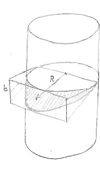

Consider a cylinder radius R intersected by a triangular wedge or prism with length 2R width R thickness t: triangular prism intersecting cylinder
Calculate the area $S$ of the shaded portion by sweeping the arrow from the position shown through $\pi/2$, noting that the height of the shaded portion at angle $\theta$ is $t\cos\theta$ and the width of swept angle $\delta\theta$ is $R \delta\theta$
$$ S = 2 \int_{0}^{\pi/2} t\cos\theta Rd\theta $$ or $$ S = 2Rt ^{\dagger} $$
