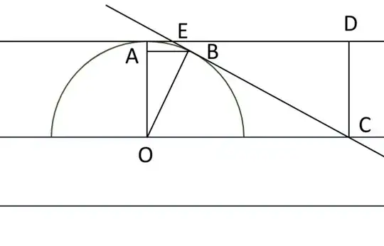

One way to proceed is to make use of the well-known (well, it should be well-known) property of a sphere: If you inscribe a unit sphere within a right cylinder, and slice them "horizontally" (i.e., perpendicular to the axis of the cylinder) the corresponding strips of the sphere and of the cylinder have equal areas.
That this is true can be seen by examining the strips in the limit. Each strip of the sphere has smaller radius than the corresponding strip of the cylinder, by an amount equal to the cosine of the "latitude" of the strip, but by the same token, the sphere's strip is wider than the corresponding strip of the cylinder, by an amount equal to the secant of the latitude. The two factors cancel each other out.*
Since the entire cylinder, neglecting the ends (which don't correspond to any portion of the sphere), has height $2$ and circumference $2\pi$, its area—and therefore the area of the sphere—is $2 \times 2\pi = 4\pi$.
*We prove that the projection ratios cancel out without triginometric functions. In the illustration below the center of the semicircle us at O, the lines OC, AB and ED are parallel, OA and DE are perpendicukar to those lines, and ED and the transversal EC are tangent to the semicircle. Then use the fact that parallel lines generate congruent alternate interior angles; thereby the corresponding angles of right $\triangle$s OBA and ECD are congruent and the triangles are similar. Thus |AB|/|OB|=|DC|/|CE| and the required cancellation of projection ratios follows.

  • I think this is a good way to visualize it, but without them having a solid foundation in trigonometry, it sounds really hand-wavy to say the smaller radius is cancelled out by thicker strips. Still, this does help me think of some ideas, so I appreciate the answer! – anonymouse Jun 21 '16 at 01:47
  • @anonymouse: I used the terminology of trigonometry, but the basic argument can be formulated in terms of similar triangles. If you draw out the cross section, I think that will make matters clearer; otherwise, I can create a drawing if you think that will help. – Brian Tung Jun 21 '16 at 02:01
  • FWIW, Wikipedia says this is the way Archimedes did it. – Qiaochu Yuan Jun 21 '16 at 03:22
    @anonymouse, look at this done with pictures: https://www.maa.org/sites/default/files/pdf/upload_library/22/Ford/Apostol496-508.pdf – hkr Jun 21 '16 at 17:49
  • We can prove that the projrlection ratios cancel without trigonometric functions. It comes directly from the geometry of the figure I added, before we would name the ratios as functions. – Oscar Lanzi Jan 07 '24 at 18:43

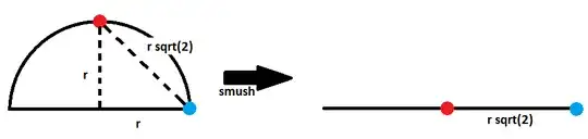

I just got done teaching the class again and it went extremely well, so I wanted to post my methods here. This isn't technically an answer, but more of what I did which works as an answer.
All credit for my fundamental idea goes to @dxiv and the link he posted in the comment to my question.
I gave each kid half of a cored orange (essentially a hemisphere) and told them to use it as a stencil to trace out a circle. They determined the radius of this first circle to be $1.6 \text{ inches}$.
I argued that the surface area is a measure of how much paint we'd need to cover the top of the half-orange. I then argued that if we smushed the orange into a flat disk, the amount of paint we need obviously wouldn't change (if we painted every point pre-smush, no point would be unpainted post-smush), so the surface area wouldn't change.
They smushed the orange and, again, used it as a stencil to trace out a circle. They found the radius of this circle to be $2.25 \text{ inches}$.
The area of our original circle, $\pi r^2$, is about $8 \text{ inches}^2$. The area of our new circle is about $16 \text{ inches}^2$. So, the surface area of the hemisphere is $2\pi r^2$, and the surface area of the full sphere is $4\pi r^2$.
They were extremely happy with this demonstration, but I obviously wasn't - it wasn't quite rigorous. So to round out the lesson, I showed them the following diagram (reproduced here in Paint):
Under the smush operation, I said that the distance between the red and blue points should not change. This would mean that our second circle should have a radius that is off by a factor of $\sqrt2$ from our first circle. Lo and behold:
$$1.6\sqrt2 \approx 2.25$$
They all left pretty satisfied, so I think the demonstration worked, sans the fact it was a bit hand-wavy.
