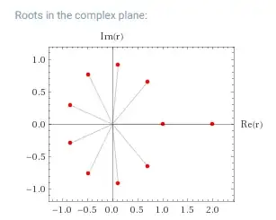

I just fed the $m=10$ case to Alpha. The dominant root is near $r=2$ as expected. The rest seem to be roughly on the circle with radius $1$ in the complex plane. The same thing happened for $[m=15][2]$. I would expect it to be general. If $r^m=1, r^{m+1}-2r^m+1 =r-1$ and we don't have to perturb $r$ much to make it work. enter image description here
