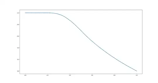

  • Well, after looking up things, I concede. You quoted a reference showing that the cdf of the longest piece is $F(x)$; this means my $f(x)$ is exactly $1-F(x)$. The Dickman F-function $F(x)$ has a simple definition from an integral equation, and its reciprocated function $\rho(x)$ is defined by the even simpler equation $\rho'(x)=-\frac{\rho(x-1)}x$. This means I can compute $f(x)$ to high precision fairly quickly. Congratulations. – Parcly Taxel Aug 09 '19 at 10:21
