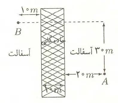

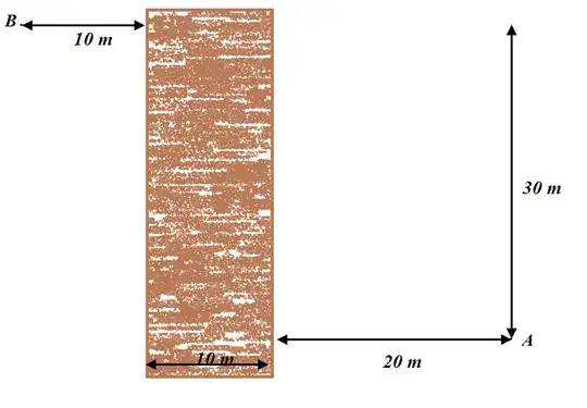

In this picture: a runner wants reach B by starting at A. Velocity in White space is $10 m/s$ and in brown space is $5 m/s$. what is the minimum time that he need? I upload original image of question but it wrote in Farsi. Assume that Brown region is a an unbounded band along the $y$ axis.
origianl image
$$a)\sqrt{26}$$ $$b)\sqrt{20}$$ $$c)5$$ $$d)\sqrt{30}$$ $$e)\sqrt{34}$$

  • I could upload that image. But original question wrote in Farsi. Assume that Brown region is a an unbounded band along the $y$ axis. – BarzanHayati Jun 29 '19 at 18:57
  • @TonyK I add original image. – BarzanHayati Jun 29 '19 at 19:02

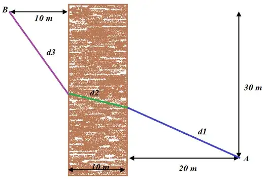

I assume that runner moves like this picture:
Path
Calculating time of moving:
$$t=\frac{d_{1}}{10} + \frac{d_{2}}{5}+\frac{d_{3}}{10}=\frac{d_{1}+d_{2}+d_{3}}{10}+\frac{d_{2}}{10} $$
we know that $d_{1}\ge20$, $d_{2}\ge10$ and $d_{3}\ge10$ Also : Direct path between $A$ and $B$ has the minimum length: So $d_{1}+d_{2}+d_{3}\ge AB$. And $AB=50$
$$ t \ge \frac{AB}{10}+1\ge 6$$
So minimum time is at least $6$.
If I move horizontally in brown region, absolutely it take more than $6$ seconds.

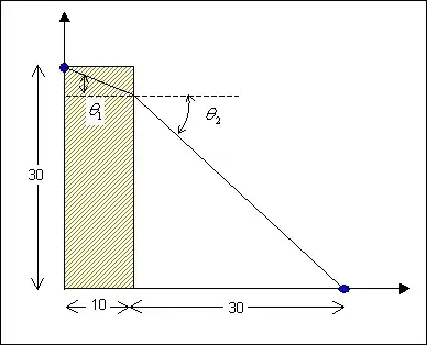

That would be the same path that a light ray would take, through media with different refractive indices.
Run_in_sand_1
Without loss of generality, we can move the "sand" stripe to start at B. Then the optical analogy will tell us that the refractive index of "sand" is $2$ and that $$ \sin \theta _{\,2} = 2\sin \theta _{\,1} $$
Without going into precise calculations, we can consider that
$$ 3/4 < \tan \theta _{\,2} < 1 $$ so that $\theta _{\,1} $ will be approximately $\pi / 8$ , which means $ \tan \theta _{\,1} \approx \sqrt{2}-1 \approx 0.4$.
Therefore the path will enter the sand strip about $4$ m below $B$.
The time is then approximately $$ t \approx {{\sqrt {100 + 16} } \over 5} + {{\sqrt {900 + 26^{\,2} } } \over {10}} \approx {{11} \over 5} + {{40} \over {10}} \approx 6.2 \approx \sqrt {38} $$ and yes, $\sqrt {34}$ looks to be too low.
Note that the path that goes straight up at $45^\circ$and then horizontally across the "sand" would take $$ t = {{10} \over 5} + {{\sqrt {1800} } \over {10}} = 2 + 3\sqrt 2 = 6.24 $$ while the straight line from $A$ to $B$ would take $$ t = {{\sqrt {100 + 900/16} } \over 5} + {{30\sqrt {1 + 9/16} } \over {10}} = {{50} \over {20}} + {{150} \over {40}} = {{250} \over {40}} = 6.25 $$

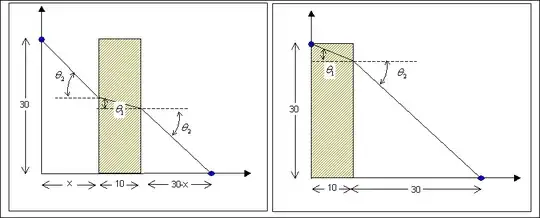

The optical analogy helps in saying that, the piecewise path from A to B which attains the minimum time to be traversed shall obey to the Refraction Law $$ {{\sin \theta _{\,1} } \over {\sin \theta _{\,2} }} = {{v_{\,1} } \over {v_{\,2} }} = {{n_{\,2} } \over {n_{\,1} }} $$ which is valid also for mechanical particles (and for humans).
Run_in_sand_2
Since the above law is bidirectional, then we will have the situation depicted in this sketch, to confirm that the horizontal placement of the sand strip is ininfluential on the total time.
The exact solution will translate into finding the solution to $$ \eqalign{ & 10\tan \theta _{\,1} + 30\tan \theta _{\,2} = 30\quad \Rightarrow \cr & \Rightarrow \quad 10{{\sin \theta _{\,1} } \over {\sqrt {1 - \sin ^{\,2} \theta _{\,1} } }} + 30{{2\sin \theta _{\,1} } \over {\sqrt {1 - 4\sin ^{\,2} \theta _{\,1} } }} - 30 = 0 \cr} $$ which leads to a 4-th degree equation, as already evidenced in a previous answer.
