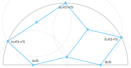

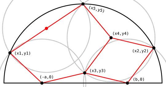

By symmetry, we can restrict ourselves to one half of the configuration, which I will take to be the upper half-plane. Then consider the smaller discs' centres and their points of intersection (both among themselves and with the outer unit disc, centred on the origin), and the following diagram is obtained:
The black dots are the key points in the problem; we will derive expressions for their coordinates later. Each red line segment is a radius of some small disc, so all of them have the same length, which I will call $r$. The red dot is the centre of the disc in the top-left corner of the diagram, and the two segments incident to it form a diameter.
Besides $r$, we define two other variables $a$ and $b$, then set the coordinates of the two key points on the $x$-axis as $A=(-a,0)$ and $B=(b,0)$ as shown in the diagram ($a,b,r$ are positive). The coordinates of the other key points can then be derived as follows (I will use $1$ to refer to the point with coordinates $(x_1,y_1)$ and so on, while $O$ assumes its usual meaning of the origin):
