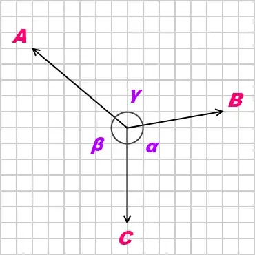

I tried to approach this using vectors. We can consider three unit vectors that add up to $0$. Unit vectors because the coefficients of the $\sin$ and $\cos$ terms are $1$. For the sake of simplicity, let one of the vectors $\overline{a}$ be along the $x$-axis. Let the angles between $\overline{b}$ and $\overline{c}$ be $\alpha$, between $\overline{a}$ and $\overline{b}$ be $\gamma$ and between $\overline{a}$ and $\overline{c}$ be $\beta$. Then we have:
$$\begin{aligned}\overline{a}&=\left<1,0\right>\\ \overline{b}&=\left<-\cos\gamma, -\sin\gamma\right>\\ \overline{c}&=\left<-\cos\beta, \sin\beta\right>\end{aligned}$$
$$\begin{aligned}\cos\gamma+\cos\beta &=1\\ \sin\beta&=\sin\gamma\end{aligned}$$
Now, $\cos \gamma$ and $\cos\beta$ must have the same sign. So we get $\sin\alpha=-\sqrt{3}/2$, $\sin\beta=\sqrt{3}/2$ and $\sin\gamma=\sqrt{3}/2$. This contradicts with the answer key provided according to which $\sum_{cyc}\sin^2\alpha=3/2$. What am I doing wrong?
This was the picture I had in mind with $\overline{a}$ aligned with the horizontal.

    You are using $\alpha$ etc., not just for the original quantities, but also for the angles between your vectors. – Angina Seng Jun 28 '19 at 06:16
  • Exactly, so the sum of the squares of the $y$-coordinates would give the required sum. Thanks for clarifying. :) – Paras Khosla Jun 28 '19 at 06:17
  • How do you obtain the last two equations ? –  Jun 28 '19 at 06:17
  • The vectors add up to $0$. That was a careless mistake. I did not prefix the negative sign with $\cos \beta$ in the vector definition. Thanks for pointing out @YvesDaoust :) – Paras Khosla Jun 28 '19 at 06:17
In the case you are dealing with, the three vectors are $(1,0)$, $(-1/2,\sqrt3/2)$ and $(-1/2,-\sqrt3/2)$. The sum of the squares of the $y$-coordinates is $$0^2+\left(\frac{\sqrt3}2\right)^2+\left(-\frac{\sqrt3}2\right)^2=\frac32.$$
The general solution though, has vectors $(\cos\alpha,\sin\alpha)$, $(\cos(\alpha+2\pi/3),\sin(\alpha+2\pi/3))$ $(\cos(\alpha-2\pi/3),\sin(\alpha-2\pi/3))$ so you need to prove the identity $$\sin^2\alpha+\sin^2\left(\alpha+\frac{2\pi}3\right) +\sin^2\left(\alpha-\frac{2\pi}3\right)=\frac32.$$

In fact the cosine equation is not
$$1-\cos\gamma-\cos\beta=0,$$
but
$$\cos\beta\cos\gamma-\sin\beta\sin\gamma-\cos\gamma-\cos\beta=0,$$
by taking the dot-products between the vectors.
The sine equation is obtained from the cross-products,
$$-\sin\beta\cos\gamma-\cos\beta\sin\gamma-\sin\gamma+\sin\beta=0.$$
These are compatible with $\alpha+\beta+\gamma=2\pi.$
  • Yes I am getting $\sin\alpha=-\sqrt{3}/2$ but turns out it contradicts with the solution. Could you clarify this? – Paras Khosla Jun 28 '19 at 06:30
  • Since $\left|\sin\gamma\right|=\left|\sin\beta\right|\implies \left|\cos\gamma\right|=|\cos\beta|$. Now, $\cos\gamma$ and $\cos\beta$ must also have the same sign for them to add up to $1$, so that means $2\cos\gamma=2\cos\beta=1$. – Paras Khosla Jun 28 '19 at 06:33
  • Since, $\alpha=2\pi-(\beta+\gamma)$ we can find its $\sin$ and $\cos$. – Paras Khosla Jun 28 '19 at 06:35
  • $\sin\alpha=-\sqrt{3}/2$ and $|\cos\alpha|=1/2$. So I am getting $\sum_{cyc}\sin^2\alpha=(3/2)^2$. – Paras Khosla Jun 28 '19 at 06:37
  • I don't think the resolution is correct somehow. To avoid resolving $\overline{a}$ because it's angle didn't fit in well with the axes, I let it be $\left<0,1\right>$. Could that be the problem? – Paras Khosla Jun 28 '19 at 06:41
  • How would that be? Is the accepted solution wrong then? – Paras Khosla Jun 28 '19 at 06:48
  • @ParasKhosla: you confused the components of $a$ and the sine/cosine of the angle between $b$ and $c$. –  Jun 28 '19 at 06:50
  • Thanks for discussing. :) – Paras Khosla Jun 28 '19 at 06:52
  • @ParasKhosla: it's all right; I will remove my comments now. –  Jun 28 '19 at 06:52
