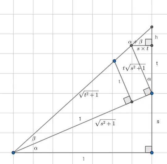

What is $\arctan{s}+\arctan{t}$? It is the addition of two angles: $\alpha+\beta$
Starting from the image we first calculate $h$:
$$\frac{h}{s\times t}=s+t+h$$
Therefore:
$$h=s\times t\frac{s+t}{1-s\times t}$$
And:
$$\tan{(\alpha+\beta)}=\frac{h}{s\times t}$$
$$\alpha+\beta=\arctan{s}+\arctan{t}=\arctan{\frac{s+t}{1-s\times t}}$$
    I'm not sure how this answers the question which was asked: i.e. why do we need the product $st < 1$? Is there a way to see this from the diagram? – Silverfish Aug 21 '23 at 13:48
