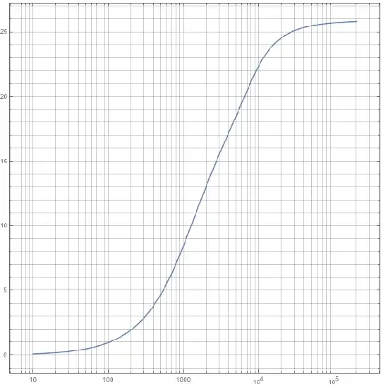

The given function does not admit an elementary closed-form inverse. A (log-linear) plot of bark as a function of frequency (Hz) is shown below, over a frequency range of $10^{-1}$ Hz to $10^5$ Hz:
Note that the function is one-to-one. You can use the graph to obtain initial guesses for an iterative numeric method solution, such as a secant method, recursive bisection, or Newton's method (which might be overkill).
My suggestion is to use the formula to calculate a table, then reverse lookup the table to get an approximation, and use linear interpolation to refine the approximation, much like what one does with tables of common statistical distributions.

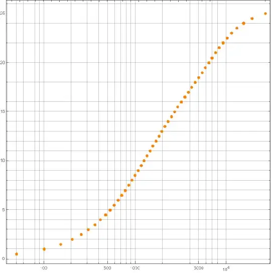

Here is a crude example in which I obtained inverse values for each half-integer value of bark from $b = 0.5$ to $b = 25$:
$$\begin{array}{|c|c|} \hline b & f \\ \hline 0.5 & 50.62 \\ \hline 1. & 101.35 \\ \hline 1.5 & 152.35 \\ \hline 2. & 203.77 \\ \hline 2.5 & 255.77 \\ \hline 3. & 308.52 \\ \hline 3.5 & 362.18 \\ \hline 4. & 416.93 \\ \hline 4.5 & 472.98 \\ \hline 5. & 530.54 \\ \hline 5.5 & 589.82 \\ \hline 6. & 651.1 \\ \hline 6.5 & 714.65 \\ \hline 7. & 780.77 \\ \hline 7.5 & 849.83 \\ \hline 8. & 922.21 \\ \hline 8.5 & 998.35 \\ \hline 9. & 1078.77 \\ \hline 9.5 & 1164.05 \\ \hline 10. & 1254.85 \\ \hline 10.5 & 1351.94 \\ \hline 11. & 1456.2 \\ \hline 11.5 & 1568.67 \\ \hline 12. & 1690.53 \\ \hline 12.5 & 1823.15 \\ \hline\end{array} \qquad \begin{array}{|c|c|} \hline b & f \\ \hline 13. & 1968.12 \\ \hline 13.5 & 2127.22 \\ \hline 14. & 2302.49 \\ \hline 14.5 & 2496.15 \\ \hline 15. & 2710.6 \\ \hline 15.5 & 2948.27 \\ \hline 16. & 3211.51 \\ \hline 16.5 & 3502.36 \\ \hline 17. & 3822.42 \\ \hline 17.5 & 4172.73 \\ \hline 18. & 4553.89 \\ \hline 18.5 & 4966.52 \\ \hline 19. & 5411.86 \\ \hline 19.5 & 5892.6 \\ \hline 20. & 6413.87 \\ \hline 20.5 & 6984.27 \\ \hline 21. & 7617.41 \\ \hline 21.5 & 8334.13 \\ \hline 22. & 9166.5 \\ \hline 22.5 & 10165.3 \\ \hline 23. & 11415.3 \\ \hline 23.5 & 13068.3 \\ \hline 24. & 15428.7 \\ \hline 24.5 & 19213.3 \\ \hline 25. & 26645.8 \\ \hline \end{array}$$
These are plotted in the figure below:

  • Are you sure about this plot (and table)? If i put in the values in the formula i get different solutions – Jan Jul 18 '16 at 10:59
  • @Jan I am not sure why, but the original plots and tables must have been calculated incorrectly. I will edit it shortly. – heropup Jul 18 '16 at 14:40
