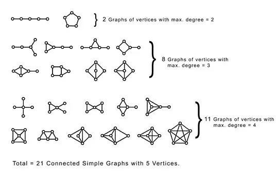

The question here is: How to find the series (or formula) to get the counting of connected simple graphs with $n$ vertices of maximum degree up to $P$? (generalizing with at least $1$ vertice with maximum degree equal to $P$)
For example, for $n = 5$ with $P=3$, we have $8$ connected graphs with at least $1$ vertice with maximum degree equal to $3$, and for $n = 5$ with $P=4$, we have $11$ connected graphs with at least $1$ vertice with maximum degree equal to $4$, as shown the degree distribution in the illustration below: enter image description here

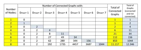

Follows a table of the count of the first groups of graphs according to the number of vertices and the maximum degree: enter image description here My question in brief is to determine the number of connected graphs with max. degree $P$ for a given number of Nodes $n$.

  • Clearly if we have the generic case we can compute the connected case. NAUTY says for the generic case we have classified by maximum degree for $n=8$ nodes: $$1, 4, 41, 378, 2166, 4869, 3843, 1044$$ which points to OEIS A263293. On the other hand restricting to the connected case NAUTY produces for $n=8$ maximum degree $$0, 0, 2, 192, 1735, 4457, 3687, 1044$$ which is not in the OEIS. Harary and Palmer list it as an open problem. – Marko Riedel Jun 08 '19 at 18:25
  • Thank you @Marko Riedel, i have seen many sequences in the OEIS but none fits this problem. I also need to start from an equation or development to prove the solution. Maybe an equation where I can define parameters to arrive at these sub-graphs. – JaberMac Jun 09 '19 at 13:05
