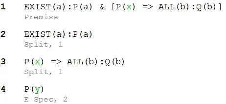

Using my DC Proof 2.0
DC Proof will not allow the use of $x$ as both a bound and a free variable within a statement, saving much confusion. As you can see, you won't be able to apply Detachment (Modus Ponens) here.
Suggestion: Try to use the lowercase letters a-j for bound variables, the remaining lowercase letters for free variables. This also avoids some confusion.
