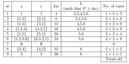

The roots of the above quadratic equation will be real if the discriminant will be non-negative, $ i.e. $ if $$b^2-4ac\geq 0 \Rightarrow b^2\geq 4ac $$ It is clear that $ a,b,c\in \{1,2,3,4,5,6\} $ as they are determined by throwing the dice.
$ \therefore\ $ the total number of possible outcomes is $ 6\times 6 \times 6=216. $
Let us find the total no. of favorable cases for the above-required probability:
Since, $ b^2\geq4ac $ and since the maximum value of $ b^2 $ is 36, $ ac=10,11,12,\ldots,36 $ is not possible. So, the probability that the above equation has real root is $ \frac{43}{216} $ $ \therefore $ Required probability $= 1-\frac{43}{216} =\frac{173}{216}$
