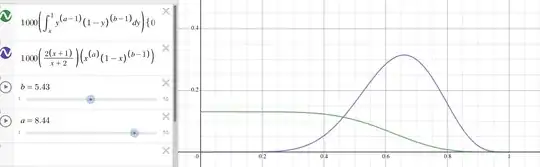

When is $f=g$ on $(0,1)$ for
$f = \int_x^1y^{a-1}\left(1-y\right)^{b-1}dy$
$g = \left(2\frac{x+1}{x+2}\right)x^{a}\left(1-x\right)^{b-1}$
Let me show their graphs. They are small, so I multiplied it by 1000. How can I estimate those functions or find an answer explicitly? screen of graphs UPD: as I move the sliders, I see, that they move the point of equality over curves that can be approximated by lines, but I am not very sure.
UPD2: I may be I can use another integral representation of Beta function, for example, $B(a,b) = 2 \int_0^{\frac{\pi}{2}} \cos^{2a-1}\theta \sin^{2b-1} \theta d\theta$, but that makes problem of defining incomplete Beta-function in this case, because integration bounds will be of type $acos(\theta)$. As discussed here, equation 15, polynomial representation is obtained from the representaton above putting $y = \cos^2\theta$.However, I don't see how that could help.

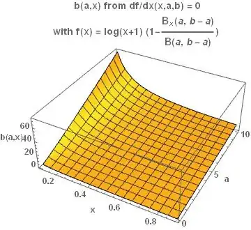

This is not a solution to the exact form of the OP but an extended comment which might be useful considering the additional information which was given in the OP.
Hence let us look at the maxima with respect to $x$ of the function defined in the "background" problem of the OP
$$f(x,a,b) = \log (x+1) \left(1-\frac{B_x(a,b-a)}{B(a,b-a)}\right)$$
After some tests I found that the overwiev of the position of the maximum can be obtained best inplicitly by the following graph. It shows the numerical solution
$$b(a,x)$$
of the equation
$$\frac{\partial}{\partial x} f(x,a,b) = 0$$.
It turns out that this form is favourable over the solution with respect to the natural variable $x$ because the solution procedure is stable.
This looks rather simple and can be described as follows: the dependence of $b$ on $a$ for given $x$ is roughly linear
$$b(x,a) = A(x) + B(x) a$$
the coefficients $A$ and $B$ depend on $x$ in a manner that can be seen in the graph.
For the precise determination of maxima in practical cases I suggest the same implicit numerical approach.
For information I provide the plot command in Mathematica which includes the root finding command.
An equivalent but more convenient form of $f'(x)$ is defined as $g1$
g1[x_, a_, b_] =
 Beta[a, -a + b] -
  Beta[x, a, -a + b] - (1 - x)^(-1 - a + b)
    x^(-1 + a) (1 + x) Log[1 + x]
and this is plotted with
 Plot3D[b /. FindRoot[g1[x, a, b] == 0, {b, a + 0.1}], {x, 0.1,
  0.9}, {a, 0, 10}]
