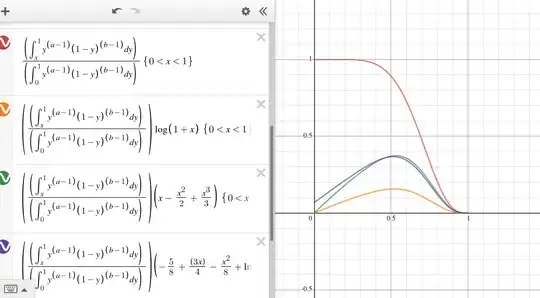

Not an answer, I have graphed this, and it's really a tricky function. But your assumption
$x \to \frac{a-1}{b-2}$
is not true. For example, $a=0.7, b = 1$, $a=10, b=14$ Good Luck!
  • Thank you @Lada Dudnikova, indeed this is not a maximizer, but only a bound. Can we prove it as a bound? I also noticed that this bound becomes tighter as $a$ and $b$ grow. (I forgot to mention $a,b>1$). – sefi Apr 28 '19 at 05:00
graphsOne more thing: I tried using McLoren series for logarithm $(1+x)$ at 0 and 1. I really don't understand why both estimations go so terribly wrong. Note that I substitute $a, b-a$ for $a,b$
https://www.desmos.com/calculator/yvvenwyafg
