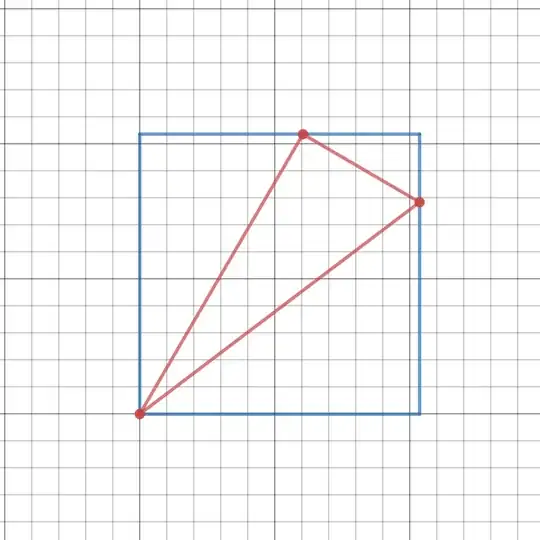

I first encounter the problem, which is, find the square with minimum length that covers a triangle with sides $5,12,13$ completely. The answer is a square with length$\frac{144}{\sqrt{193}}$ and I believe so, using the method here.
But the problem is, why is it the smallest possible square covering the triangle?
My attempts:
If a square covers the triangle and at the same time they have some vertex(s) coinciding:
If it is $\angle BAC$ touching vertex of square, see here, the square covering it should have side length of at least 12.
If it is $\angle BCA$ touching the vertex of square, see here, the square covering it should also have side length of at least 12.
This leaves us to the problem of $\angle ABC$, see here or below:enter image description here It is the smallest because whatever it is rotated clockwise/anti-clockwise through the origin, the side length of square will be larger.
For every square covering a triangle, there is a smaller square covering the same triangle while touching at least a vertex using its vertex(s). But how does it implies that the side length of square is at least $\frac{144}{\sqrt{193}}$? I mean, a square which touches the triangle with its vertex may have a shorter side length, but why is there no square with side length even shorter (doesn't touch the triangle using its vertex)? Why do we need only to consider these three cases?
Any help will be appreciate! Thank you.

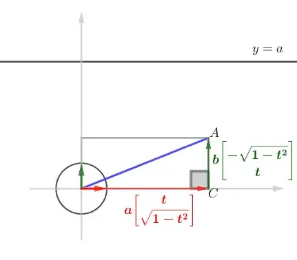

Let us solve the general problem of fitting any given right triangle into a minimal enclosing square.
Place it like in the following diagram so that WLOG $b$ is the shortest leg and $B$ is at the origin:
Note the gray enclosing rectangle parallel to the axes. Finding the minimal enclosing square corresponds to minimizing the longest side of this rectangle. In our analysis, the following observations can be utilized:
  • We only need consider $90^\circ$ degrees rotation since after that the axes-parallel rectangles essentially repeat the same pattern (this was already noted in the more general related question).
  • We know that $a$ is a candidate side length for the minimal enclosing square, so we need not consider the cases where $A$ exceeds above the line $y=a$.
  • As the triangle rotates away from the $x$-axis, the height of the gray rectangle increases while the width decreases.
Now we can describe the rotated triangle via the unit vectors as shown in the diagram: $$ \color{red}{ \mathbf e_1= \begin{bmatrix} t\\ \sqrt{1-t^2} \end{bmatrix} } \qquad\text{and}\qquad \color{darkgreen}{ \mathbf e_2= \begin{bmatrix} -\sqrt{1-t^2}\\ t \end{bmatrix} } $$ In the relevant region (where $A$ is below $y=a$), we can deduce that the gray rectangle has the following dimensions: $$ \begin{align} \text{width}&=at\\ \text{height}&=a\sqrt{1-t^2}+bt \end{align} $$ And so we can find the minimal square by solving: $$ \text{width}=\text{height}\iff at=a\sqrt{1-t^2}+bt $$ which can be solved for $t$: $$ t=\frac{a}{\sqrt{a^2+(a-b)^2}} $$ and so the minimal square has side length: $$ \text{width}=at=\frac{a^2}{\sqrt{a^2+(a-b)^2}} $$ Finally, plugging in $a=12,b=5$ yields: $$ \text{width}=\frac{144}{\sqrt{193}} $$ As a last comment, note that in case $a=b$ the formula yields $\text{width}=a$ which is correct for that case too, so this covers all cases for right angled triangles.

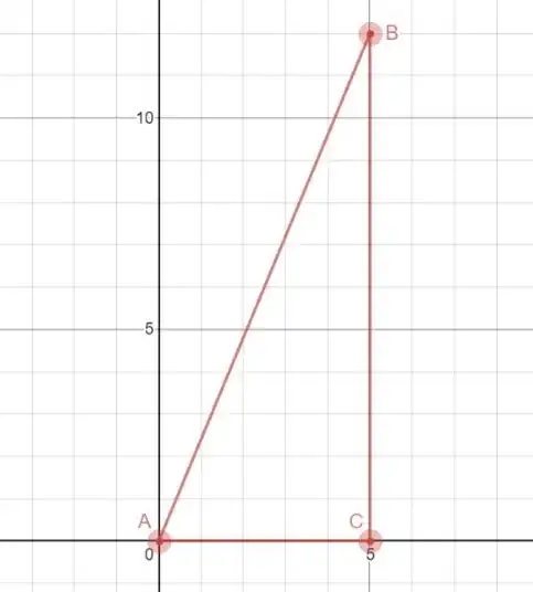

This answer shows that $\frac{144}{\sqrt{193}}$ is the smallest possible side length.
(This is an answer to the question "why is it the smallest possible square covering the triangle?", but I have to say that this is not an answer to the question "Why do we need only to consider these three cases?". Anyway, I hope this helps.)
Let $A(0,0), B(5,12), C(5,0)$.
First, let us consider the condition that three points $A,B,C$ exist between two parallel lines $L_1$ and $L_2$ whose slope is $\tan\theta\ (0\lt \theta\lt\frac{\pi}{2})$ where the distance between $L_1$ and $L_2$ is $d$.
We may suppose that $L_1$ passes through $C$, so we may write $$L_1 : y=\tan\theta\ (x-5),\qquad L_2 : y=\tan\theta\ x+\frac{d}{\cos\theta}-5\tan\theta$$
The condition that three points $A,B,C$ exist between $L_1$ and $L_2$ is $$0\le \tan\theta\times 0+\frac{d}{\cos\theta}-5\tan\theta\quad \text{and}\quad 12\le\tan\theta\times 5+\frac{d}{\cos\theta}-5\tan\theta,$$ i.e. $$\sin\theta\le\frac d5\quad\text{and}\quad \cos\theta\le\frac{d}{12}\tag1$$
Next, let us consider the condition that three points $A,B,C$ exist between two parallel lines $L_3$ and $L_4$ whose slope is $\tan(\theta+\frac{\pi}{2})\ (0\lt \theta\lt\frac{\pi}{2})$ where the distance between $L_3$ and $L_4$ is $d$.
We may suppose that $L_3$ passes through $A$, so we may write $$L_1 : y=\tan\left(\theta+\frac{\pi}{2}\right)x,\qquad L_2 : y=\tan\left(\theta+\frac{\pi}{2}\right)x+\frac{d}{\sin\theta}$$
The condition that three points $A,B,C$ exist between $L_3$ and $L_4$ is $$0\le \tan\left(\theta+\frac{\pi}{2}\right)\times 5+\frac{d}{\sin\theta}\quad \text{and}\quad 12\le\tan\left(\theta+\frac{\pi}{2}\right)\times 5+\frac{d}{\sin\theta},$$ i.e. $$\cos\theta\le\frac d5\quad\text{and}\quad 12\sin\theta+5\cos\theta\le d\tag2$$
Finally, let us prove that if there exists a pair of $(d,\theta)$ satisfying both $(1)$ and $(2)$, then $d\ge \frac{144}{\sqrt{193}}$.
We have $$\small\begin{align}&(1)(2)\\\\&\implies\cos\theta\le\frac{d}{12}\quad\text{and}\quad \sqrt{1-\cos^2\theta}\le\frac{d-5\cos\theta}{12} \\\\&\implies \cos\theta\le\frac{d}{12}\quad\text{and}\quad 1-\cos^2\theta\le \frac{d^2-10d\cos\theta+25\cos^2\theta}{144} \\\\&\implies \cos\theta\le\frac{d}{12}\quad\text{and}\quad 169\cos^2\theta-10d\cos\theta+\color{blue}{d^2-144}\ge 0 \\\\&\implies \frac{5d+12\sqrt{169-d^2}}{169}\le \cos\theta\quad\text{and}\quad \cos\theta\le\frac{d}{12} \\\\&\left(\because\ \text{we already know that $d=\frac{144}{\sqrt{193}}\approx 10.4$ is possible, so we may suppose that $\color{blue}{d^2-144}\lt 0$}\right) \end{align}$$
In order for such $\theta$ to exist, we have to have $$\begin{align}&\frac{5d+12\sqrt{169-d^2}}{169}\le \frac{d}{12} \\\\&\implies\sqrt{169-d^2}\le\frac{109}{144}d \\\\&\implies 169-d^2\ge 0\quad\text{and}\quad 169-d^2\le \left(\frac{109}{144}d\right)^2 \\\\&\implies 0\lt d\le 13\quad\text{and}\quad d\ge\frac{144}{\sqrt{193}} \\\\&\implies \frac{144}{\sqrt{193}}\le d\le 13\qquad\blacksquare\end{align}$$

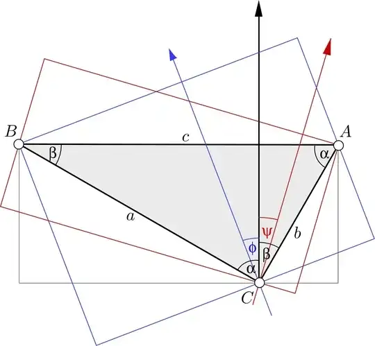

We work with a right triangle having legs $a\geq b$ and hypotenuse $c$. Its angles then satisfy $$0<\beta\leq{\pi\over4}\leq\alpha<\pi\ .$$ We circumscribe rectangles around this triangle, starting with the black rectangle in the figure. This rectangle is either turned to the right by an angle $\psi\in[0,\beta]$ (drawn as red rectangle), or is turned to the left by an angle $\phi\in[0,\alpha]$ (drawn as blue rectangle).
These red or blue rectangles are covered by squares of side lengths $$s(\psi)=\max\{c \cos\psi, b\cos(\beta-\psi)\}=c\max\{\cos\psi, \sin\beta\cos(\beta-\psi)\}\qquad(0\leq\psi\leq\beta)\ ,\tag{1}$$ resp., $$s(\phi)=\max\{c\cos\phi, a\cos(\alpha-\phi)\}=c\max\{\cos\phi,\sin\alpha\cos(\alpha-\phi)\}\qquad(0\leq\phi\leq\alpha)\ .\tag{2}$$ Since $\beta\leq{\pi\over4}$ we know that for $\psi\in[0,\beta]$ one has $$\cos\psi\geq\cos\beta\geq\sin\beta\geq\sin\beta\cos(\beta-\psi)\ ,$$ so that $(1)$ gives $s(\psi)=c\cos\psi\geq c\cos\beta$.
Since $\alpha\geq{\pi\over4}$ the first entry $\cos\phi$ on the RHS of $(2)$ is monotonically decreasing in the interval $0\leq\phi\leq\alpha$ from $1$ to $\cos\alpha$. At the same time the second entry $\sin\alpha\cos(\alpha-\phi)$ is monotonically increasing from $\sin\alpha\cos\alpha<1$ to $\sin\alpha\geq\cos\alpha$. It follows that $s(\phi)$ is minimal at the unique point $\phi_*\in[0,\alpha]$ where these two graphs intersect: When $\phi<\phi_*$ then $s(\phi)=\cos\phi>s(\phi_*)$, and when $\phi>\phi_*$ then $s(\phi)=\sin\alpha\cos(\alpha-\phi)>s(\phi_*)$.
Solving $$\cos\phi=\sin\alpha\cos(\alpha-\phi)\tag{3}$$ leads to $$\tan\phi_*={1-\sin\alpha\cos\alpha\over\sin^2\alpha}\ .$$ From $(3)$ we obtain $\cos\phi_*\leq\sin\alpha=\cos\beta$. This makes sure that by choosing $\phi=\phi_*$ we obtain a smaller square than with choosing the $\psi$-side treated before. Therefore the smallest square has side length $$s(\phi_*)=c\cos\phi_*=c{\sin^2\alpha\over\sqrt{1-2\sin\alpha\cos\alpha+\sin^2\alpha}}={a^2\over\sqrt{c^2-2ab+a^2}}\ .$$ For $(a,b,c)=(12,5,13)$ one obtains $s(\phi_*)={144\over\sqrt{193}}$.
The task standing contains solution with the square side $z<12.$ This means that the optimal solution achieves when the vertex B is in corner of the square and the points $A,C$ are on the different sides of the square.
Let WLOG $$B=(0,0),\quad A=(x,z),\quad C=(z,y),$$ then the optimal solution should satisfy the conditions in the form of
$$ \begin{cases} x,y\in(0,z]\\ x^2+z^2 = 169\\ (z-x)^2+(z-y)^2=25\\ z^2+y^2=144. \end{cases} \tag1 $$
The system $(1)$ can be resolved: $$\begin{cases} 2(x+y)z = 288\\ x^2-y^2 = 25\\ z^2+y^2=144 \end{cases} \quad\rightarrow\quad \begin{cases} (x+y)z = 144\\ 144(x-y)z=25z^2\\ z^2+y^2=144, \end{cases}$$ $$\begin{cases} 288yz = 144^2-25z^2\\[4pt] 288^2(144-z^2)z^2 = (144^2-25z^2)^2\\[4pt] z^2>\dfrac{13}{\sqrt2}, \end{cases}$$ $$83569 z^4 - 12980736 z^2 + 429981696 = 0,$$ $$(313z^2-20736)^2-120z^4=0,$$ with the correct solution ($x\in(0,z]$)
$$\color{green}{\mathbf{z=\dfrac{144}{\sqrt{193}}}}.$$
I,e., OP solution presents the single minimum.
I think this consideration solves the given problem.
