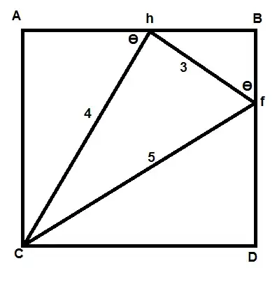

Here is the square and the right triangle inscribed in it.
I did the following: $$AC = Ah + hB$$ $$4\sin\theta = 4\cos\theta + 3\sin\theta$$ So $$\tan\theta = 4$$ But $$\sin\theta = \frac{\tan\theta}{\sqrt{1+\tan^2\theta}}$$ Therefore $$AC = 4\sin\theta = \frac{16}{\sqrt {17}}$$ $$\text{Area} = \left(\frac{16}{\sqrt {17}}\right)^2$$

I think your way is good, but we don't need to find $\tan\theta$.
From $4\sin\theta=4\cos\theta+3\sin\theta$, we have $$\sin\theta=4\cos\theta$$ Squaring the both sides gives $$\sin^2\theta=16(1-\sin^2\theta)$$ from which we can have $$\sin^2\theta=\frac{16}{17}\quad\Rightarrow\quad \text{(area)}=16\sin^2\theta=\frac{16^2}{17}$$

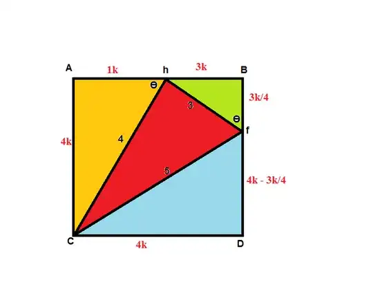

Here is another way of doing it.
After discovering that $\tan \theta = 4$, all the line segments can then be expressed in terms of k with Ah = 1k as a start.
Find the value of $k^2$ from $$16k^2 – \triangle yellow – \triangle green – \triangle blue = \triangle red = \dfrac {3 \times 4}{2}$$
Required area follows.

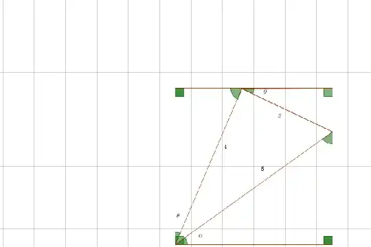

let's say $AC=x$ , $Ah=y$ and therefore $hB=x-y$. $hAC$ and $fBh$ are similar triangles so:
$\frac{x}{4}=\frac{x-y}{3} $
$y=\frac{x}{4}$
$\frac{x^2}{16}+x^2=16$
$x^2=\frac{256}{17}$
