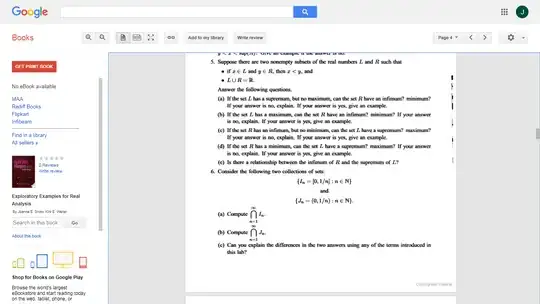

Need help in vetting my answers for the questions here in CRM series book by MAA: Exploratory Examples for Real Analysis, By Joanne E. Snow, Kirk E. Weller.
Suppose there are two nonempty subsets of real numbers, $L$ and $R$, such that:
- if $x \in L, y \in R$, then $x \lt y$, and
- $L \cup R =\mathbb{R}$.
Answer the following questions :
(a) If the set $L$ has a supremum, but no maximum, can the set $R$ have an infimum? minimum?
If your answer is no, explain. If your answer is yes, give an example.
(b) If the set $L$ has a maximum, can the set $R$ have an infimum? minimum?
(c) If the set $R$ has an infimum, but no minimum, can the set $L$ have a supremum? maximum?
(d) If the set $R$ has an minimum, can the set $L$ have a supremum? maximum?
