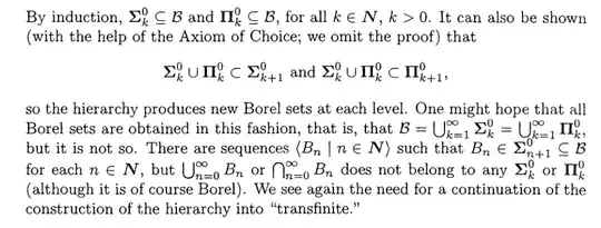

My textbook Introduction to Set Theory 3rd by Hrbacek and Jech introduces $\mathcal B$, the set of all Borel sets, and then mentions that
I have tried, but only to successfully prove that there exists an ordinal $\delta$ such that ${\bf \Sigma}_\delta^0 = {\bf \Sigma}_{\delta+ 1}^0 = {\bf \Pi}_\delta^0 = {\bf \Pi}_{\delta+ 1}^0$.
Please help me prove
${\bf \Sigma}_\alpha^0 \cup {\bf \Pi}_\alpha^0 \subsetneq {\bf \Sigma}_{\alpha+1}^0$ and ${\bf \Sigma}_\alpha^0 \cup {\bf \Pi}_\alpha^0 \subsetneq {\bf \Pi}_{\alpha+1}^0$ for all ordinal $\alpha < \omega_1$.
