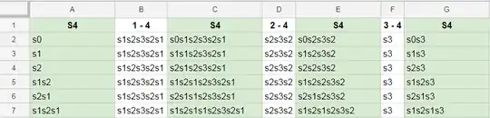

If you have the list of words (representing functions) for the $n$ group,
$$\quad w_1, w_2, \dots, w_{n!}$$
you can mechanically generate the words for the $n+1$ group using two facts:
$\quad \text{Every (new) permutation has the form } w \circ \tau \text{ for a transposition } \tau = (k \; \; n+1)$
$\quad \text{Every transposition can be written as a product of adjacent transpositions}$
We will use this theory to get the words for $S_4$.
To organize the work, we created a google sheet; here are the $24$ elements in $S_4$ ($s_0$ is the identity):
We did not work on representing these words with the shortest length. For example, the word in cell $\text{C7}$ can obviously be reduced in length.
I am not aware of the theory that would give us an algorithm to do this.
