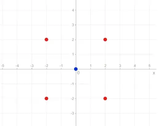

Shortly after this, I came across a question in my book that provided a picture of 4 red dots (image below) and asked, "How many ellipses do these 4 red points define". Having read the comments on my post with the circle, I thought that this was fairly straight forward.
I chose " 1 ".
This was wrong. The answer was infinite. This caught me as surprising as I didn't think of the equations for a circle and an ellipse as differing by much beyond a scaling factor for each quadratic term.

The equation of an ellipse is: $$ ax^2+by^2+cxy+dx+ey+f=0 $$ Hence you need $5$ points to obtain the coefficients: $(a,b,c,d,e,f)$, assuming that the center is unknown.
If, on the the other hand, the center is known then $3$ points are enough, since every point's reflection in respect to the center is also a point of the ellipse and you technically have $6$ known points.
In this case, assuming that the blue-painted point is the center, the points you've been given are symmetric in respect to it and thus it's like having the center and $2$ points, which is not enough to uniquely determine an ellipse.

  • So it seems to me that the symmetry of these points provided is the issue? – S.C. Jan 06 '19 at 09:01
    Exactly. Assuming that the blue-painted point is the center, the points you've been given are symmetric in respect to it and thus it's like being given the center and $2$ points, which is not enough to uniquely determine an ellipse. – Andrew Jan 06 '19 at 09:07

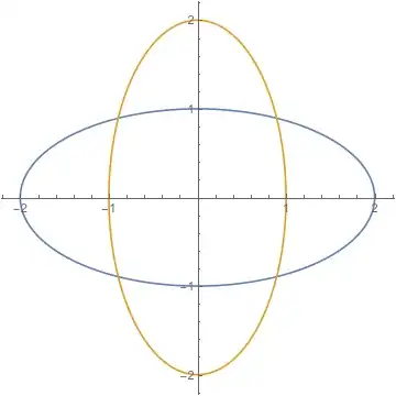

The equation $\left(\frac{x-h}{a}\right)^2 + \left( \frac{y-k}{b}\right)^2 = 1$ is the equation for an ellipse with major and minor axes parallel to the coordinate axes. We expect such ellipses to be unchanged under horizontal reflection and under vertical reflection through their axes. In this equation, these reflections are effected by $x \mapsto 2h - x$ and $y \mapsto 2k -y$.
This means, if all you have is one point on the ellipse and the three reflected images of this point, you do not have $8$ independent coordinates; you have $2$ and uninformative reflections forced by the equation.
We can see this by plotting two ellipses at the same center (same $h$ and $k$), intersecting at $4$ points, with, say, semiaxes of length $1$ and $2$.

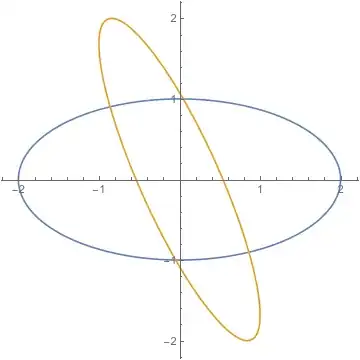

These clearly have four points of intersection. But as soon as you know an ellipse is centered at the origin and contains any one of the four points of intersection, by the major and minor axis reflection symmetries, it contains all four. This is still true if you use generic ellipses, which can be rotated.
Mathematica graphics
Remember that the reflections are through the major and minor axes, wherever they are.

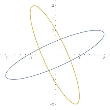

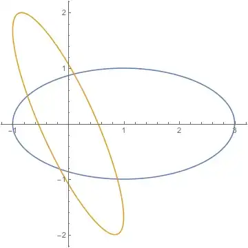

Of course, there are other ways for two ellipses to intersect at four points.
So just knowing those four points are on an ellipse cannot possibly tell you which one is intended.

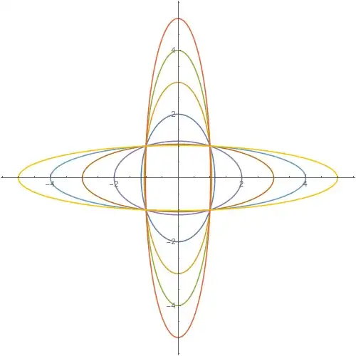

Consider a subset of the set of ellipses passing through the $4$ red points, that contains ellipses that pass through the points and are centred at $(0,0)$ with axes parallel to the coordinate axes. The general equation of an ellipse belonging to this subset is $$\frac{x^2}{a^2}+\frac{y^2}{b^2}=1$$ Since the $4$ points lie on the ellipse, plug them into its equation. Notice that plugging any point generates the same equation, $$4/a^2+4/b^2=1$$ You have two unknowns $a,b$ and only one equation. This means there are infinitely many ordered pairs $(a,b)$ that satisfy the condition, hence the subset is infinite, which in turn implies the set of ellipses that pass through the given points is infinite.
Shubham Johri
  • 17,739
  • Doesnt this only occur because all the points have the same value when squared (i.e. 2^2 and (-2)^2. What if they didnt have the same value and were scattered around the place. – S.C. Jan 06 '19 at 08:59
    Yes, it is because they have the same value on squaring. This, and also because you don't seem to be aware of the general equation of an ellipse in the $xy$ plane whose axes of symmetry are not necessarily parallel to the co-ordinate axes, is the reason I chose this specific subset. – Shubham Johri Jan 06 '19 at 09:03
  • So, just for clarification, if these 4 points were not symmetrically arranged, 4 would be enough (in the subset where the ellipse is axes are parallel to the coordinate axes and centered at zero). – S.C. Jan 06 '19 at 09:06
  • In that case, $2$ points would be enough to prove that the subset is singleton, because you have $2$ unknowns, $a,b$, but that doesn't say anything about the cardinality of the original set. Note that these $2$ points should not be symmetric about the co-ordinate axes or the origin. – Shubham Johri Jan 06 '19 at 09:13
  • Is it fair to say that for the image I provided, a single point can be used to derive the remaining 3? i.e. that image really only contains "1 useful point". (due to the symmetries) – S.C. Jan 06 '19 at 09:15
    Yes, a single point can be used to infer three more points for an ellipse centred at $(0,0)$ and with axes parallel to the coordinate axes. If your point is $(a,b)$, then the other three points are $(a,-b),(-a,b)(-a,-b)$. – Shubham Johri Jan 06 '19 at 09:22
