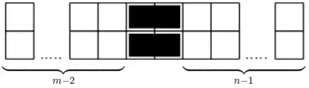

1) The covering has a pair of horizontal dominoes at position $m-1$ and $m$. enter image description here
Therefore on the left side we have a covering of a $2\times (m-2)$ grid and on the right side we have a covering of a $2\times (n-1)$ grid. Therefore the number of such coverings is $F_{m-1}\cdot F_{n}$.

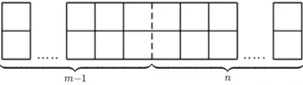

2) The covering can be split into two coverings, one of a $2\times (m-1)$ grid and another of a $2\times n$ grid. enter image description here
Therefore the number of such coverings is $F_{m}\cdot F_{n+1}$.
