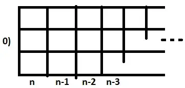

So we start with a grid such as

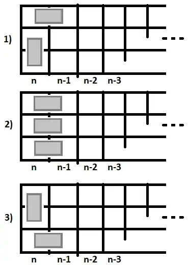

To make a first step in the iteration, we ask the question: how can we put a number of dominos on this grid in all different ways such that the first column labeled by $n$ is covered completely?
The possible variations clearly are:
This reveals that apart from the initial $3\times n$ type grid, the number of different tilings for which we can denote as $f_n$, we also need to consider a second grid of $3\times n$ type with one corner missing, the number of tilings for which we call $g_n$. (By symmetry, it does not matter whether an upper or lower corner is missing, the number of tilings will be the same.)
Therefore, the above all possible coverings of the first column labeled by $n$ suggest the recurrence
$$f_n = f_{n-2}+2g_{n-1}$$

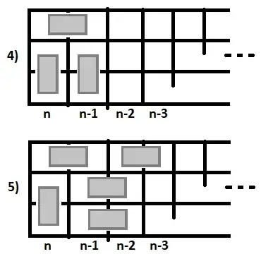

Since we have introduced the quantity $g_n$, it seems we need a recurrence relation for it as well. For that end, we consider all possible ways to add dominos to the grid 1) above, such that all squares of column $n-1$ are covered:
Note that in grid 5) we also have added an additional domino occupying columns $n-2$ and $n-3$ at the top, since this is the only possible way to cover the remaining square in column $n-2$ anyway.
This suggests the following recurrence for $g_n$:
$$g_{n-1}=f_{n-2}+g_{n-3}$$
