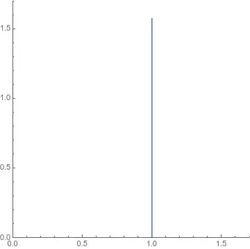

The exponential could be interpreted as an infinite process, as you can see in the gif below: enter image description here
since $$ b=a e^{\theta e_1 e_2}\cong a(1+\frac{\theta e_1 e_2}{N})^N=a+\frac{\theta}{N}a_{\perp}+\cdots $$
