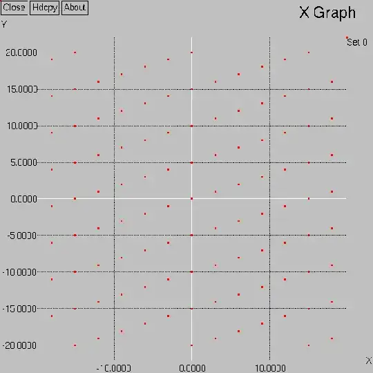

A sample plot below for $m=3$.
It turns out to be the same final grid as $(p',q) \to (mq,(m+2)p'+q)$
It then turns out that the closest two points (tied with many others) are:
  • $(0,0) \to (0,0)$
  • $(0,1) \to (m,1)$
So the minimum distance is $\sqrt{m^2+1}$
