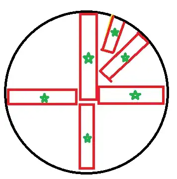

The short answer is that you can't cut a 2-dimensional object into 1-dimensional objects that have zero width. You could try cutting your circle into thick line segments, but that wouldn't work because they would all crowd together near the center (and overlap, so you would be double counting).
Imagine you have a fat marker. You can easily draw a line from the center to the edge). But now, the second line that you will try to draw from the center has to start a little farther away from the true center, otherwise you'll overlap. And after you've drawn about 4 lines (in the shape of a cross), the 5th line is going to be even harder to draw close to the center. My sketch shows the fat marker lines, and the green stars are the centers of the fat lines, and you can see they are not all the same distance.
If you want to cut your circle into smaller objects, then you could consider cutting it into triangles, and then calculating the average distance from the apex of the triangle. The more triangles you have, the less error you have near the circumference where the triangle's straight edge underestimates the curved edge.

    Actually, your point about how thick line segments overlap is an intuitive explanation for why the expected value is greater than half. It's exactly that the segments toward the centre have their probability "discounted" to adjust for it, while those toward the perimeter do not, and maintain "full value" as it were. So the points in each segment toward the perimeter have greater likelihood than those toward the centre. – Nij Nov 30 '18 at 03:01
