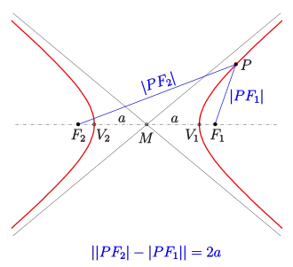

Your basis is close to a basis that diagonalises$$M=\begin{pmatrix}8&3\\3&0\end{pmatrix}$$ $M$ has matrix of unit length eigenvectors $$P=\begin{pmatrix}\frac{3}{\sqrt{10}}&\frac1{\sqrt{10}}\\\frac1{\sqrt{10}}&-\frac{3}{\sqrt{10}}\end{pmatrix}$$ so that $$P^tMP=\begin{pmatrix}9&0\\0&-1\end{pmatrix},$$ transforming your equation $$\begin{pmatrix}x&y\end{pmatrix}\begin{pmatrix}8&3\\3&0\end{pmatrix}\begin{pmatrix}x\\y\end{pmatrix}+\begin{pmatrix}-\frac1{\sqrt{10}}&\frac{3}{\sqrt{10}}\end{pmatrix}\begin{pmatrix}x\\y\end{pmatrix}-1=0$$ by $\begin{pmatrix}x\\y\end{pmatrix}=P\begin{pmatrix}x'\\y'\end{pmatrix}$ into $$\begin{pmatrix}x'&y'\end{pmatrix}\begin{pmatrix}9&0\\0&-1\end{pmatrix}\begin{pmatrix}x'\\y'\end{pmatrix}+\begin{pmatrix}0&-1\end{pmatrix}\begin{pmatrix}x'\\y'\end{pmatrix}-1=0$$ or $$9x'^2-y'^2-y'-1=0,$$ from which you can easily get by $x''=x', y''=y'+\frac12$ that $9x''^2-y''^2-\frac34=0$ or $$(\frac{x''}{\frac1{2\sqrt{3}}})^2-(\frac{y''}{\frac{\sqrt{3}}{2}})^2=1$$ which is in standard form $\frac{x^2}{a^2}-\frac{y^2}{b^2}=1$ and is just a rotation and translation of your original hyperbola.
Now you can find the foci: $b^2=c^2-a^2\implies c^2=\frac56$. So $(x',y')=(\pm \sqrt{\frac{5}{6}},-\frac12)$ or $(x,y)= (\frac{\sqrt{30}-1}{2\sqrt{10}},\frac{10\sqrt{3}+9\sqrt{10}}{60})\approx(0.71,0.76)\text{ and }(-\frac{1+\sqrt{30}}{2\sqrt{10}},\frac{3}{2\sqrt{10}}-\frac1{2\sqrt{3}})\approx(-1.02,0.19)$ and use the definition to draw it using $2a=\frac1{\sqrt{3}}\approx 0.58$ and this video:
hyperbola from wikipedia

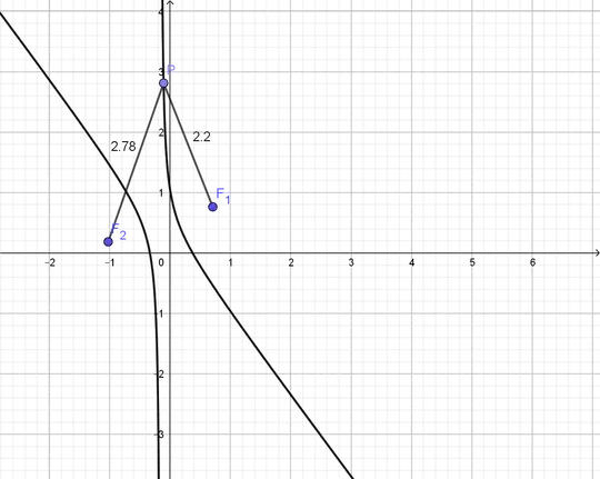

If you just want to plot it, use something like geogebra and the command
ImplicitCurve(8x^2+6x y-x/sqrt(10)+3y/sqrt(10)-1)
hyperbola in geogebra
