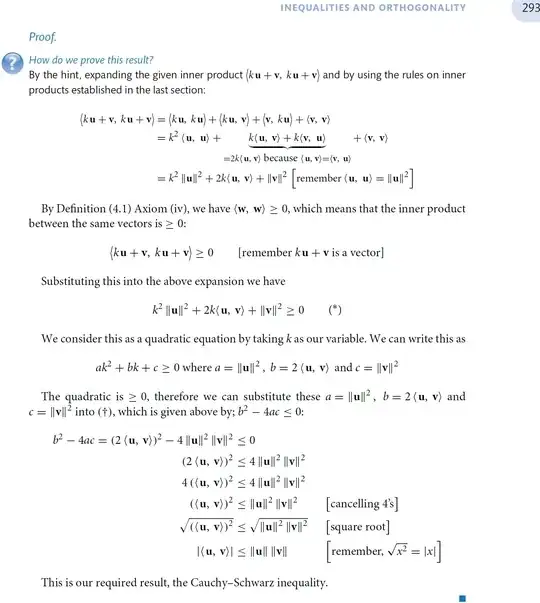

Kuldeep Singh's Linear Algebra: Step by Step (2013) proves this at p 293.
