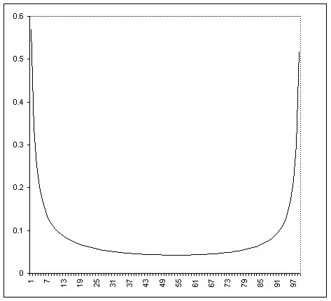

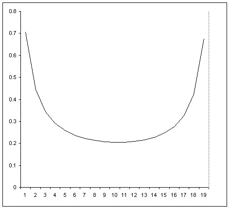

It suggests that there exists of a general pattern for $\{y_k\}$. Below are graphs for $\{y_k\color{red}{-1}\}$ for $n=20$ (which provides $d(20)\ge 0.4750702$) and $n=100$ (which provides $d(100)\ge 0.3156195$). I remark that the last value is more than twice bigger than $\frac{7\ln 2}{8\ln 100}=\frac{7}{8\log_2 100}=0.1317006\dots$, so I guess that analytic description of the pattern can lead to a proof of a strong inequality. As an aid I provide below the (rounded) sequence $\{y_k-1\}$ for $n=100$.
0.568813293
0.339731947
0.250658592
0.202100545
0.171168765
0.149589419
0.133606711
0.121254158
0.111401006
0.103346372
0.096632292
0.090945372
0.086065313
0.081830815
0.078121791
0.074847124
0.071934277
0.069329774
0.06698533
0.064867893
0.062946908
0.06119601
0.059597855
0.058134021
0.056788616
0.055549986
0.054408614
0.053355081
0.052381164
0.051477808
0.050642813
0.049869636
0.049150712
0.048487213
0.047870011
0.047300624
0.046773765
0.046287301
0.045839285
0.045426464
0.045050178
0.044705127
0.044392893
0.044110562
0.043858542
0.043635059
0.043439437
0.043271504
0.043130179
0.043015646
0.042927185
0.042864435
0.042829168
0.042819848
0.04283657
0.042881058
0.042952044
0.043050421
0.043179212
0.043337126
0.043524287
0.043744926
0.043999354
0.044286068
0.044612369
0.044977226
0.045381648
0.045832647
0.046329917
0.046878054
0.047482742
0.048146738
0.048877411
0.049679262
0.05056174
0.051533042
0.052601587
0.053782408
0.055087981
0.05653489
0.058146492
0.059945903
0.06196218
0.06423862
0.066818627
0.069766721
0.073161067
0.077108166
0.081748879
0.087280503
0.093985299
0.10227286
0.11278736
0.126570241
0.145453179
0.172979978
0.217060498
0.299864157
0.518985805
