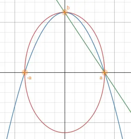

$\hspace {2cm}$enter image description here
We know that the ellipse $$\frac {x^2}{a^2}+\frac {y^2}{b^2}=1\tag {1}$$ intercepts the axes at $(\pm a, \pm b)$.
It is interesting to note that the parabola $$\frac {x^2}{a^2}+\frac yb=1\tag {2}$$ intercepts the axes at $(\pm a,0),(0,b)$.
and that the line $$\frac xa+\frac yb=1\tag{3}$$ intercepts the axes at $(a,0), (0,b)$.
Question
Are equations $(1),(2), (3)$ related to each other, given that they appear very similar in form, i.e. can they be derived from the same equation with a change in parameter, or as one parameter tends to infinity, etc?
For instance, we know that if we fix $b=a$ in $(1)$ then we get a circle. Can $(1)$ be modified such that it becomes $(2)$ and then $(1)$?
NB Perhaps the Wiki reference on Superellipse may be useful.
If you view the line as half of a degenerate "crossed-lines hyperbola" then the three curves can be parameterized by a variable second vertex.
Define $$A = (2a,-b) \qquad B = (0,b) \qquad C = (-2a,-b) \qquad D = \left(-2a \delta, \frac{b}{\varepsilon}\right) \qquad E = \left(2a\delta, \frac{b}{\varepsilon}\right)$$
Note that I've moved things around a little, placing the origin halfway between the fixed vertex and the line containing the two other fixed points. (I've also made the distance between that point and line $2b$ instead of just $b$, and the distance between the two points on the line $4a$ instead of $2a$.) This is so that three special cases are easily described:
  • $\varepsilon = \phantom{-}1$: Crossed lines through the upper fixed point.
  • $\varepsilon = -1$: Parallel lines through the three fixed points.
  • $\varepsilon = \phantom{-}0$. Parabola.
The specified ellipse corresponds to $\varepsilon = -1/3$.
These five points determine a conic with equation $$\begin{align} 0 &= \left|\begin{array}{cccccc} x^2 & y^2 & x y & x & y & 1 \\ A_x^2 & A_y^2 & A_x A_y & A_x & A_y & 1 \\ B_x^2 & B_y^2 & B_x B_y & B_x & B_y & 1 \\ C_x^2 & C_y^2 & C_x C_y & C_x & C_y & 1 \\ D_x^2 & D_y^2 & D_x D_y & D_x & D_y & 1 \\ E_x^2 & E_y^2 & E_x E_y & E_x & E_y & 1 \end{array}\right| \\[6pt] &= \frac{32 a^2 b^2 \delta (1 + \varepsilon)}{\varepsilon^3} \left(\;(1 - \varepsilon ) \left( - b^2 (1+\varepsilon) x^2 + 2 a^2 (y - b) (\varepsilon y - b)\right) + 4 a^2 \delta^2\varepsilon^2 \left( b^2 - y^2 \right) \;\right) \end{align}$$ Conveniently ignoring the possibility that $\delta$ could be zero (or that $\varepsilon$ could equal $0$ or $-1$), we remove the leading factor. But then we dutifully take $\delta$ to be $0$ anyway, so that points $D$ and $E$ coalesce at a vertex of the conic. The resulting equation can be written
$$\frac{x^2}{a^2}\;\frac{1+\varepsilon}{2} \;=\; \frac{(y - b) (\varepsilon y - b)}{b^2}\tag{$\star$}$$
Let's review the special cases ...
  • $\varepsilon = 1$: Crossed lines.
$$\frac{x^2}{a^2} = \frac{(y - b)^2}{b^2} \qquad\to\qquad y = \pm \frac{b}{a} x + b$$
  • $\varepsilon = -1$: Parallel lines.
$$0 \;=\; (y - b) (y + b) \qquad\to\qquad y = \pm b$$
  • $\varepsilon = 0$: Parabola.
$$\frac{x^2}{a^2} \;=\; - \frac{y - b}{b} \qquad\to\qquad y - b = -\frac{b}{a^2}x^2$$
  • $\varepsilon = -1/3$. Ellipse centered the midpoint of $\overline{AC}$.
$$\frac{x^2}{a^2} \;=\; -\frac{(y - b) (y + 3 b)}{b^2} \qquad\to\qquad \frac{x^2}{(2a)^2} + \frac{(y+b)^2}{(2b)^2} = 1$$
