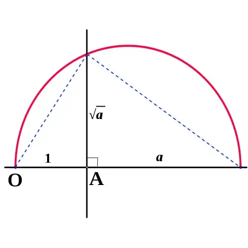

It is easy to construct $\sqrt a$ for each $a$ that is constructible: enter image description here
(picture from commons.wikimedia)
