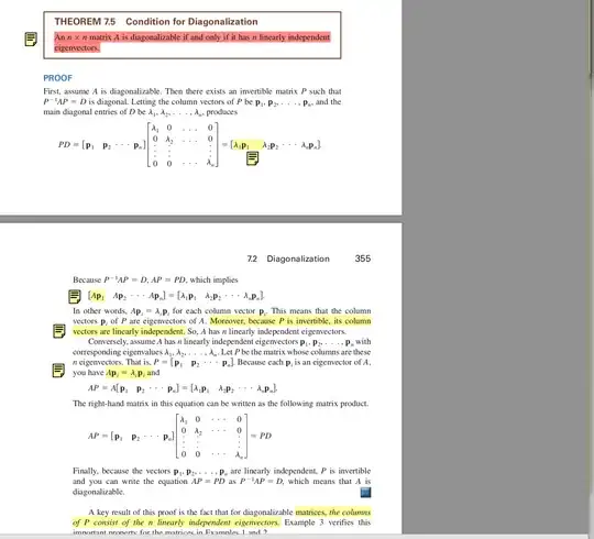

I'm following this theorem
Condition for Diagonalization
A $n \times n$ matrix is diagonalizable iff it has $n$ linearly independent eigenvectors.

This is the proof that I'm relying on:
