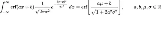

Also, the approach in this question could not be applied since, like in my case, the lower limit is $0$ instead of $-\infty$.

Here in this question you can refer to this integral.
error function related integral
Well this might prove useful might not be good solution just noticed it.
