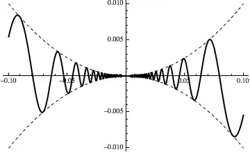

The basic example of a differentiable function with discontinuous derivative is $$ f(x) = \begin{cases} x^2 \sin(1/x) &\mbox{if } x \neq 0 \\ 0 & \mbox{if } x=0. \end{cases} $$ The differentiation rules show that this function is differentiable away from the origin and the difference quotient can be used to show that it is differentiable at the origin with value $f'(0)=0$. A graph is illuminating as well as it shows how $\pm x^2$ forms an envelope for the function forcing differentiablity.

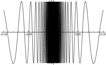

The derivative of $f$ is $$ f'(x) = \begin{cases} 2 x \sin \left(\frac{1}{x}\right)-\cos \left(\frac{1}{x}\right)&\mbox{if } x \neq 0 \\ 0 & \mbox{if } x=0, \end{cases} $$ which is discontinuous at $x=0$. Its graph looks something like so

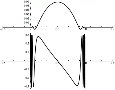

The next step is to modify this example to obtain a function that is everywhere differentiable with a derivative that is continuous on all of $\mathbb R$, except for two points. To this end, consider $$ f(x) = \begin{cases} x^2 (1-x)^2 \sin \left(\frac{1}{\pi x (1-x)}\right)&\mbox{if } 0<x<1 \\ 0 & \mbox{else}. \end{cases} $$ The graph of $f$ and its derivative look like so.

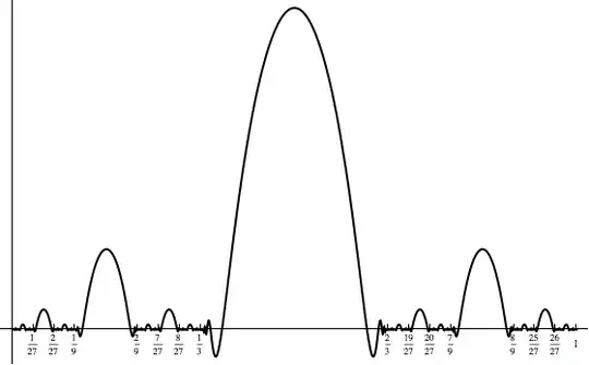

Now that we have a way to construct a differentiable function whose derivative is discontinuous exactly at the endpoints of an interval, it should be clear how to construct a differentiable function whose derivative is discontinous on a Cantor set constructed in the interval. For $n\in\mathbb N$ and $m=1,2,\ldots,2^n$, let $I_{m,n}$ denote one of the $2^n$ intervals removed during the $n^{th}$ stage of construction of the Cantor set. Then let $f_{m,n}$ be scaled to have support $I_{m,n}$ and to have maximum value $4^{-n}$. The function $$F(x) = \sum_{n=0}^{\infty} \sum_{m=1}^{2^n} f_{m,n}(x)$$ will be everywhere differentiable but its derivative will be discontinuous on the given Cantor set. Assuming we do this with Cantors standard ternary set, we get a picture that looks something like so:
Of course, there's really a sequence of functions here and care needs to be taken to show that the limit is truly differentiable. Let $$F_N(x) = \sum_{n=1}^{N} \sum_{m=1}^{2^n} f_{m,n}(x).$$ The standard theorem then states that, as long as $F_N$ converges and $F_N'$ converges uniformly, then the limit of $F_N(x)$ will be differentiable. This is guaranteed by the choice of $4^{-n}$ as the max for $f_{m,n}$.
