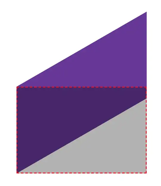

I am trying to play around applying transformations to rectangle.

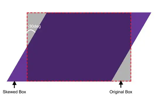

In this picture, I skewed a box by -30 degrees on the Y axis to get the following. The purple box is the transformed box and the dashed border, transparent box is the original one.

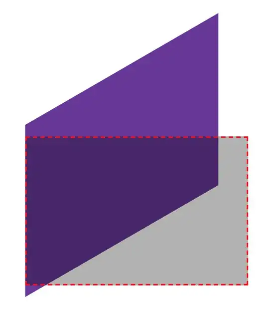

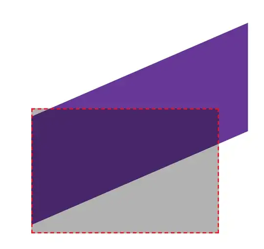

I was thinking if I can achieve the same by first skewing on the X axis and then rotating the box to compensate for the skewing done.
But I got a very different result. enter image description here
At first, it's probably because or the order of those transformations done so I flipped them but this time I got another different result. Essentially the opposite of the previous one.
What I am unable to understand is that from Picture 2, it seemed like skewX and rotate by the same amount would work but it didn't.

Do observe the second column of the matrix of the combined transformation. Its top entry is equal to zero. This means that the combined transformation does map the $y$-axes to itself. But you see from the bottom entry of that second column that the combination stretches the distance between points on the $y$-axis by a factor of $1/\cos\theta.$ This factor is $>1$ when $\theta$ is non-trivial.
The difference between $1$ and $1/\cos\theta$ shows in your images in that the left vertical side of the purple parallelogram in the last image is longer thatn the height of the rectangle.
On the other hand, if you first rotate and the $x$-skew, you get the matrix product $$ S_xR=\left(\begin{array}{cc}1/\cos\theta&0\\ \sin\theta&\cos\theta\end{array}\right). $$ Again, the $y$-axis is mapped onto itself, but this time the stretching factor is $\cos\theta <1$. You see this in your third image.
