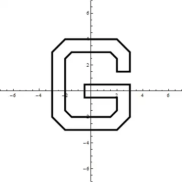

I think the following matrix product gives an explanation.
The first step is given by the matrix $$ S_1=\left(\begin{array}{cc}1&\tan\theta\\0&1\end{array}\right). $$
The second step corresponds to $$ D_1=\left(\begin{array}{cc}1&0\\0&\frac{1}{\cos^2\theta}\end{array}\right). $$
The second shearing operation corresponds to $$ S_2=\left(\begin{array}{cc}1&0\\-\tan\theta&1\end{array}\right). $$
At this point we have done $S_2D_1S_1$ that after a little bit of matrix manipulation and using the identity $\sin^2\theta +\cos^2\theta=1$ becomes $$ S_2D_1S_1=\left(\begin{array}{cc}1&\tan\theta\\-\tan\theta&1\end{array}\right). $$
The last step amounts to a scalar multiplication by $\cos\theta$ and gives us the familiar rotation matrix $$ \cos\theta S_2D_1S_1=\left(\begin{array}{rc}\cos\theta&\sin\theta\\-\sin\theta&\cos\theta\end{array}\right). $$
Edit: I got to use this as an exercise in a freshman course that just ended. I was actually a bit unhappy with that youtube video, because it doesn't show the transitions from one step to the other. To fix this problem I made an animation, where the four steps are done gradually: in steps one and three I continuously move the shear (skew) parameter from zero to the desired value. Similarly in steps two and four the scaling parameter changes continuously from one to the proper value. All the steps are done sequentially.
