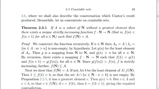

Let $A$ be a nonempty subset of $\Bbb N$ without a greatest element. Then there exists a unique, strictly increasing, and surjective mapping $f:\Bbb N \to A$.
In my textbook, the author said that this theorem is very important since many other theorems regarding the countability depend on it. Although the author presented a clear proof, I also roll the sleeve and give it a shot.
Does this proof look fine or contain gaps? Do you have suggestions? Many thanks for your dedicated help!

Update: I added a screenshot here.
