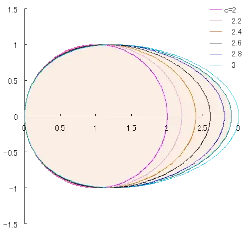

I'm attempting to find the bounding box for a rotated egg shape without resorting to interpolation if at all possible. In researching this I've come across this link which lists useful equations for plotting the $(x, y)$ coordinates of an egg shape as:
\begin{align*} x &= \frac{r((c-2) \cos \theta + c + 2)(\cos \theta + 1)}{4}, \\ y &= r \cdot \sin \theta. \end{align*}
But if I were to normalize it to the centerpoint of the circular area—$(0, 1)$ in the image below, then rotate it by some arbitrary angle about that new centerpoint­—how can the $x$ and $y$ bounds be found without interpolation?

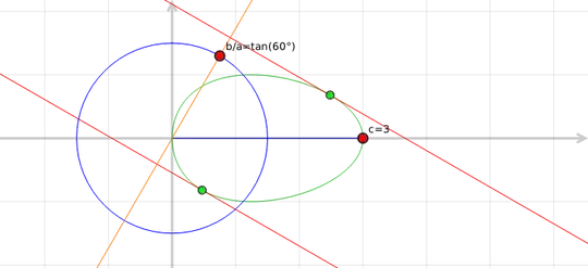

Below is a snapshot of one instance of this problem. See this blog page for an interactive version with some additional text.
Figure

    @CoryG: I created an interactive version for you and other readers. Applying the transformation you applied to the egg to these extremal points as well shouldn't be too hard. Note that only the direction of $(a,b)$ is important, so you might pick $a=\cos\varphi,b=\sin\varphi$ where $\varphi$ depends on the rotation of the egg. I'm not sure what expansion and compression you are talking about. – MvG Aug 22 '18 at 22:24
