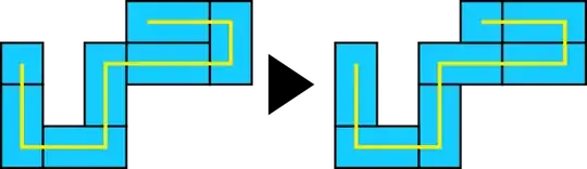

Here are two example, $R$ in yellow, and $S$ in red.

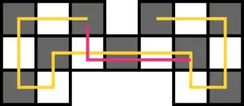

If $R$ has peaks, we can find an example where it fails:

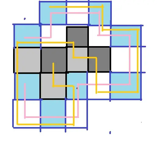

If I understand your definitions right and if you'll forgive the crude MSPaint diagram, I think this example shows that such a polyomino can be nontileable. Here the orange line traces out the strip for $R$, the pink line traces it for $S$, and the light/dark gray squares are the squares remaining in $R-S$, which are clearly non-tileable.
Polyomino

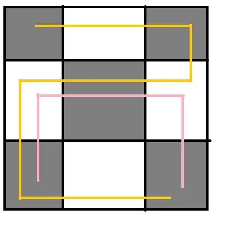

Edit: on second thought, a simpler example can be found in the 3x3 square, where $S$ is again traced out by the pink line:
3x3 square with path removed
