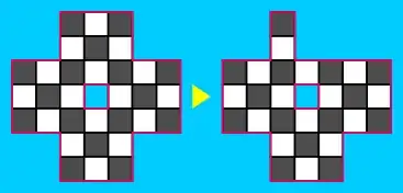

Proof. For this proof to work, we will manipulate the border (either the outside or inside border) to give a new polyomino with a hole, and we will consider regions where borders overlap also valid polyominoes, and they are even if the corners are black as with the regular definition. Here are some examples of such polyominoes (the outside border has been slightly displaced where it coincides with the inside border).
Here, tileable means tileable by dominoes.

  2. A peak is a cell with exactly one neighbor. In an even polyomino, all peaks must be black (otherwise there are white corners). Also, all black peaks must be attached to a white cell with exactly two neighbors. Therefor, in an even polyomino, if we move the border to exclude the peak and it's neighboring cell, we are still left with an even polyomino.
An example of this manipulation:
  1. A $2 \times 2$ square can be of two types. Type I has a black square in the top right, a Type II square has a black square in the top left. If a Type I square occurs in a corner of the polyomino, we can move the border to exclude it, and keep the polyomino even.
