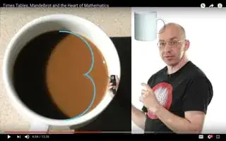

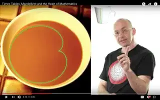

The Mathologer video Times Tables, Mandelbrot and the Heart of Mathematics discusses several relationships. For the n=2 and 3 cases, the cardiod and catacaustic (or nephroid per @Rahul's comment) curves are shown in reflections in coffee cups.
In the case of the cardiod the cup must be conical but presumably not cylindrical, for the catacaustic it must be a cylinder.
Question: If I wanted to construct these caustics using Blender, what are the specific constraints on the shapes of the coffee cups and directions of illumination? Can the former be any converging or diverging cone, and does the illumination direction need to have the same angle as that of the cone? Must the later be a perfect cylinder and the illumination only oblique?
