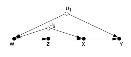

In Judea Pearl's The Book of Why we find the following causal diagram:
Causal diagram
where $U_1$ and $U_2$ are unobserved variables.
The diagram is accompanied by a comment that ensures that neither the back door criterion nor the front door criterion are sufficient to figure out the causal effect $P(Y | do(X))$.
However, as I understood the back door criterion, it should be enough to control for $Z$.
The backdoor paths from $X$ to $Y$ are $X\leftarrow Z \leftarrow W \leftarrow U_1 \rightarrow Y$, and $X\leftarrow U_2 \rightarrow W \leftarrow U_1 \rightarrow Y$.
If we block $Z$, then the first path becomes blocked. And the second path is blocked without a need to control variables by the collider at $W$.
So what is going on? Why is my analysis wrong?

By conditioning on Z, which is a descendant of W, we will be opening the backdoor path $X\leftarrow U_2 \rightarrow W \leftarrow U_1 \rightarrow Y$.

EDIT BY OP: Here I copy the solution to the puzzle that was shared on twitter.
\begin{align*} P(y|do(x)) &= P(y|do(x),do(z),do(w))\\ &=P(y|x,do(z),do(w))\\ &=P(y|x, do(z))\\ &=\sum_w P(y|x,do(z),w)\,P(w|x,do(z))\\ &=\sum_w P(y|x,do(z),w)\,P(x|do(z), w)\,P(w|do(z))/P(x|do(z))\\ &=\sum_w P(y|x, z, w)\,P(x|z,w)\,P(w) \sum_w P(x|w,do(z))\,P(w|do(z))\\ &=\sum_w P(y|x,z,w)\,P(x|z,w)\,P(w) \sum_w P(x|w,z)\,P(w). \end{align*}
