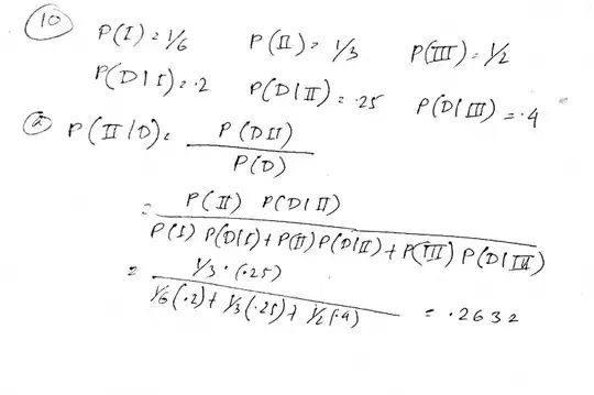

For the first qt, the solutions say the probability of selecting box 1 is 100/600, box 2 200/600, and box 3 300/600, but that doesnt make sense to me because if the boxes are separate, why would the amount of components matter? If the question said that all the components were scattered into one place and then we select at random, then it would make sense that the probability of selecting from each box wouldn't be 1/3 - ie, the amount of components that were originally in each box would matter. Below is the solution (is it wrong?) for qt 1

  • ok so the probability is 1/3 for each unless otherwise stated right? i dont understand why they did it differently in the solution – David Jul 17 '18 at 20:02
  • @David Yes. If the is no other information we should assume that. It is a miracle for me as well. Does the given solution have another result? If yes, which one? I can only say something serious only if I know the whole calculation of the given solution. But I think they´re on the wrong track. – callculus42 Jul 17 '18 at 20:07
  • I've added the solution to qt 1 in the original post..can you please take a look – David Jul 17 '18 at 20:24
  • @David It can be seen that it is assumed that the probability of selecting box i is not equal for all 3 boxes. But as far as I can see this is not mentioned in the exercise. Usually "selecting randomly" means selecting with equal probability. – callculus42 Jul 17 '18 at 20:31

  • if the qt had said all the components were mixed together and then we randomly selected one, then wouldn't the probability of selecting a component that was originally in box 1,2,or 3 change? – David Jul 17 '18 at 20:34
  • Sure it does since the larger box still preserves more weight... – Mostafa Ayaz Jul 17 '18 at 20:37
