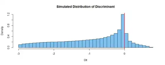

Because OP has shown no engagement, I expect this Question might be closed soon. In this comment, I will show only the approximate value $P(\Delta < 0) = 0.875,$ obtained from an easy simulation in R. (A million iterations should give 3-place accuracy; three such simulations agree to three places.)
a = runif(10^6);  b = runif(10^6); Dlt = .75*a^6 - 3*b^2
mean(Dlt < 0)
## 0.875421

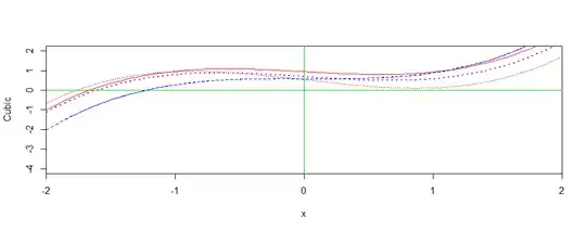

Here are four of the one million cubic curves in the simulation above. All of them happen to have one real root (each at $x < -1);$ one of them 'almost' had three real roots.
