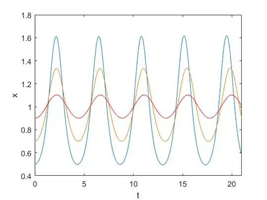

I am studying a periodic physical system with a nonlinear ODE $$x''=f(x)+g(x)x'^2$$
I think the periodicity comes from the $x'^2$ term because this provides two possible numbers to give a same right hand side value.
The following shows three numerical curves of this equation with $f(x)=x-x^3$ and $g(x)=2/x-x$. enter image description here
We can see that the curve is oscillating about the fixed point (by making $x''=0$ and $x'=0$, here the fixed point is $x^*=1$)
I can solve the period for the almost fixed-point solution $x(t)=x^*+\epsilon \cdot \cos{\omega t}$ and this perturbation gives me a frequency $\omega=\sqrt{-f'(x^*)}$. For the particular example I gave, $\omega=\sqrt{-f'(1)}=\sqrt{-(1-3\cdot 1^2)}=\sqrt{2}$ so $T=2\pi/\omega=\sqrt{2}\pi \approx 4.44$ and it matches the red curve pretty well.
My question is how can I analytically solve the period of the curves far away from the fixed point solution?
Thank you for you attention!
