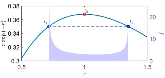

The numerical verification is shown below: The interval of integral
$\uparrow$ The interval of the integral and the integrand

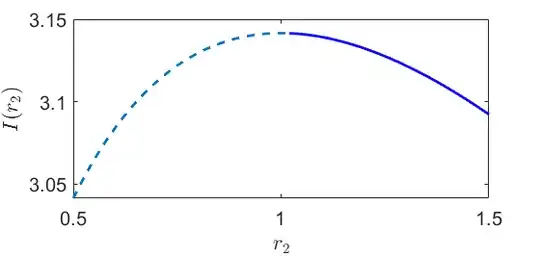

integral as a function of r2
$\uparrow$ The integral as a function of $r_2$

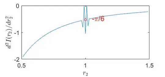

Thanks to Fabian, the second derivative at $r=1$ matches $I=\pi-\frac{\pi}{12}\epsilon^2+O(\epsilon^3)$: secondOrder
$\uparrow$ The above is the numerical second order derivative of figure 2.
